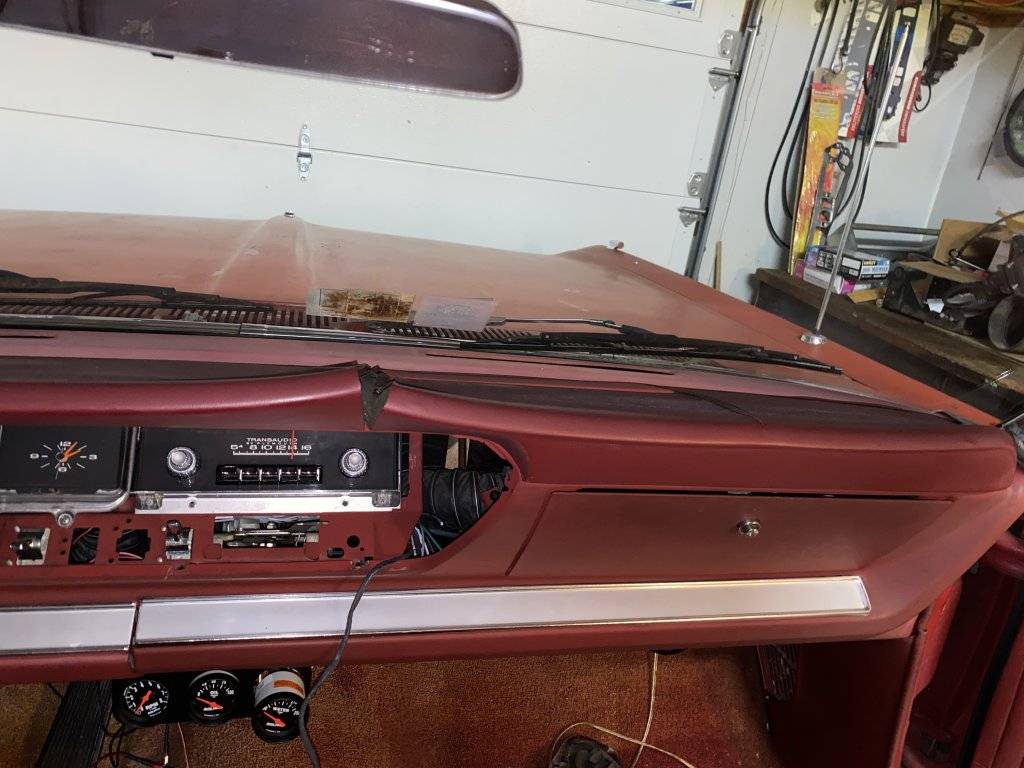

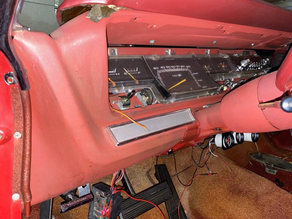

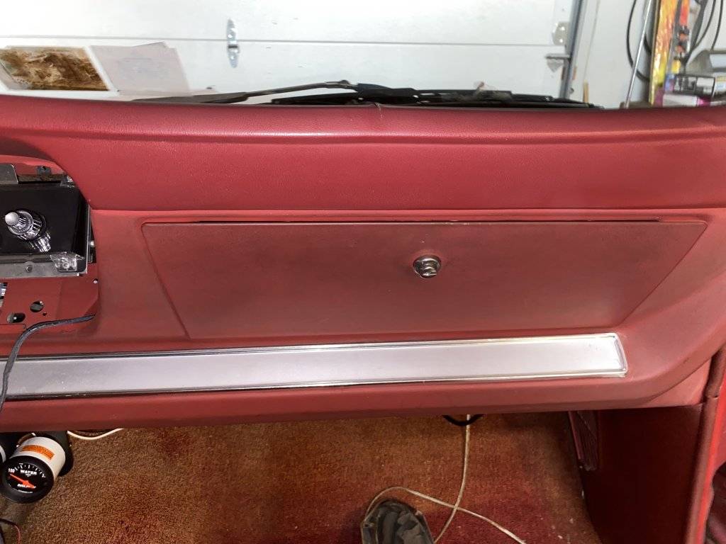

Here's what I'm working with. Not the best pictures. Just went out to the garage and turned the flash on.

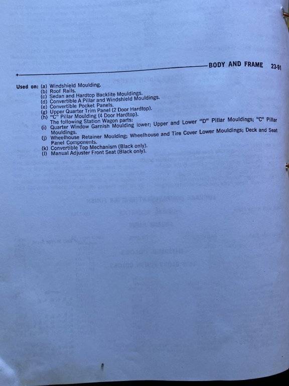

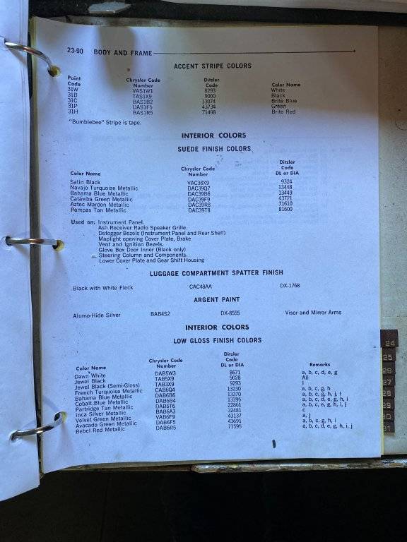

In the service manual towards the back is a listing of interior colors and what pieces they used them on (at least for the 68 Polara’s). For instance my dash and dash pad are Aztec Maroon suede. My a-pillars and interior roof rails are rebel red metallic as well as the sail panels. The dash pad on mine is the same tone as the Aztec poly which is my metal dash frame as well.
Last page in the service manual. Example for the Dodge Polara and Monaco, not the Fury.

From your pictures it does look like the “rebel red metallic” vs my Aztec, but I am sure Plymouth had a different name.
