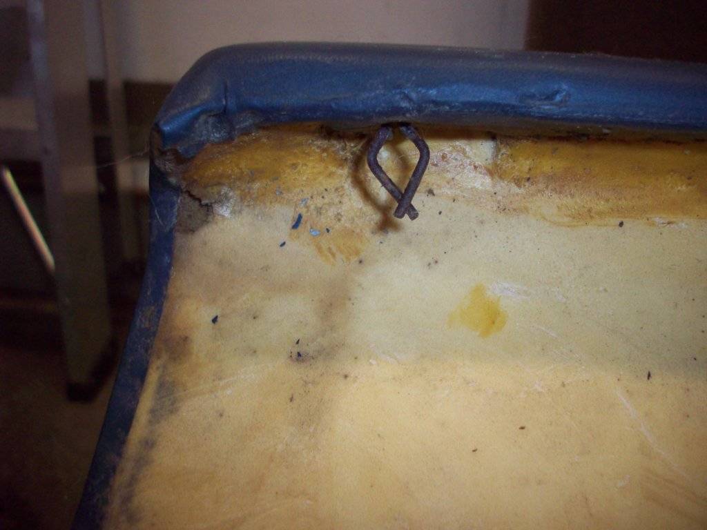

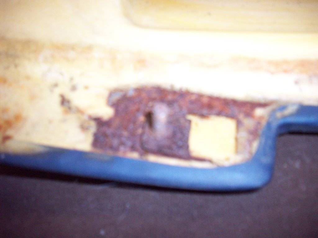

    there should be 8 studs attached to the dashpad following the curve of the windshield. the nuts need to be removed from under the dash with a deep socket. once you pop the dashpad up clearing the studs of the dash you can then pull the liner towards you. there are 2 clips to deal with,one on each corner that pop into holes similar to clips on a fibreboard door panel. there may be more clips but only see two on mine. hope this helps clay.
