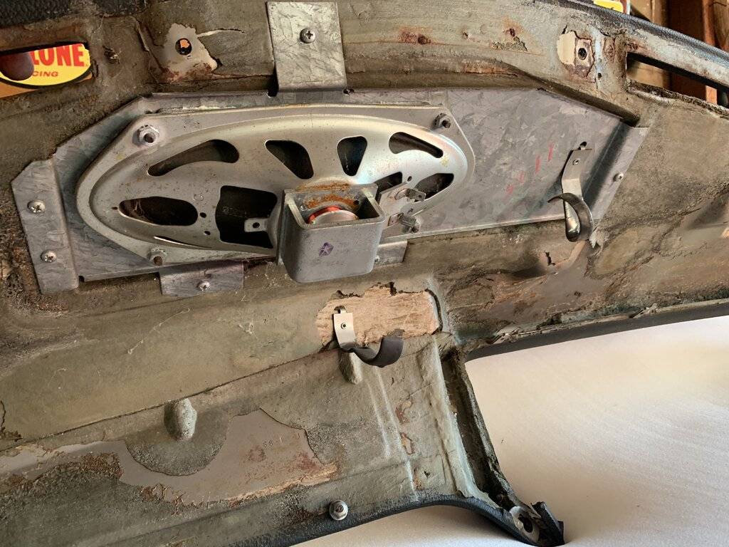

Going to replace the dash pad in my 69 Fury. My experiences from e body ownership had me pull the speaker grill hardware and just silicone the grill in place. Seemed like if you pulled the hardware you had a better chance of the dash not splitting.

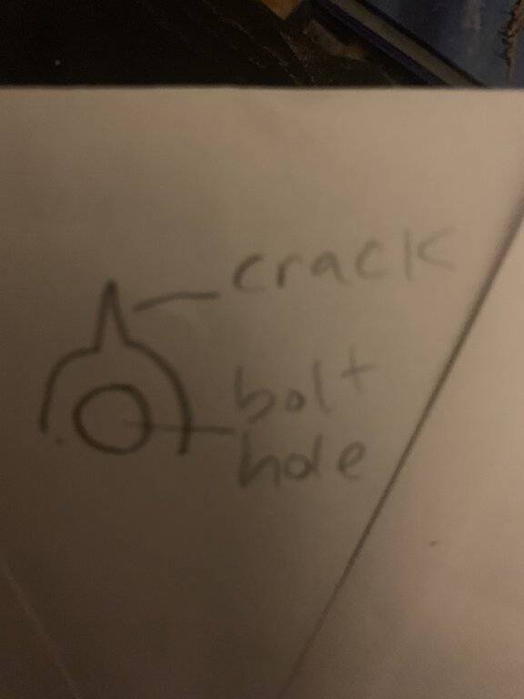

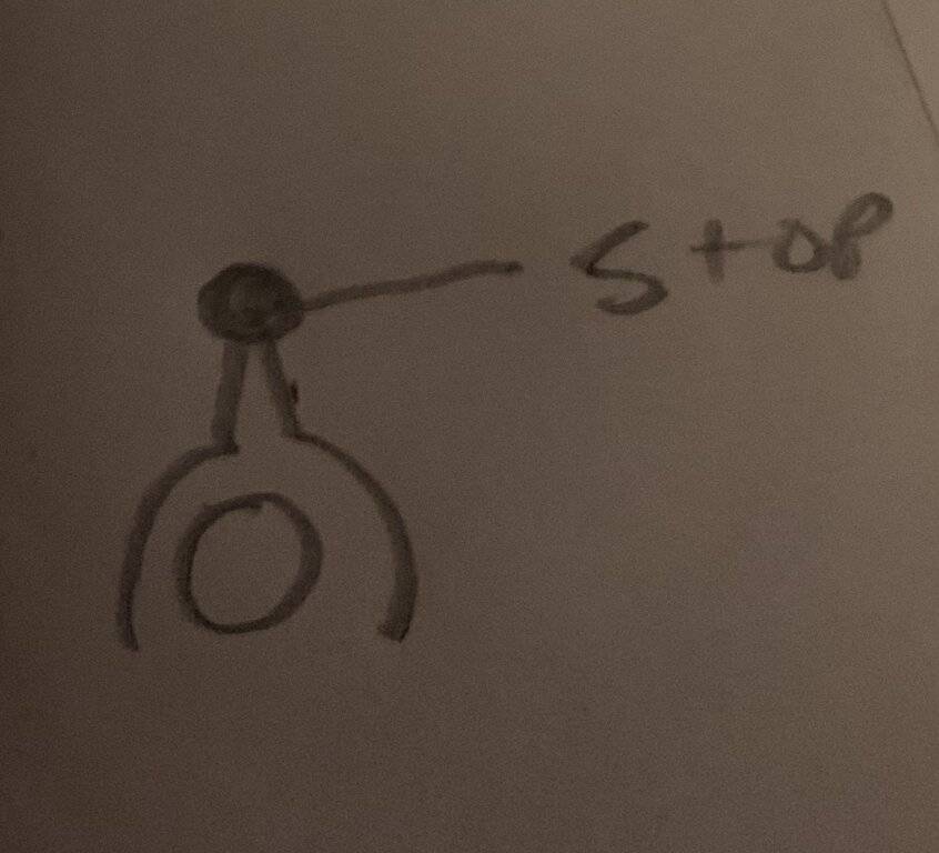

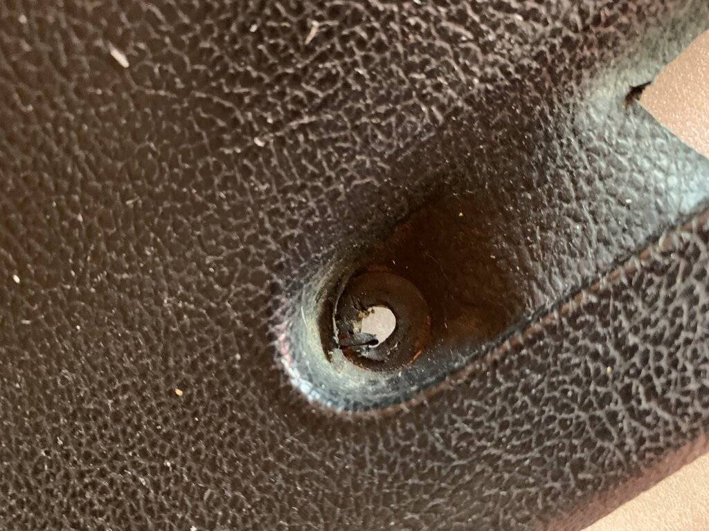

Looking at my destroyed pad I’m thinking about pulling the speaker and speaker support. Looks like a major crack starting spot. The other spots are where the bolts hold the dash pad to the cowl. There are a few tiny cracks that haven’t gone anywhere yet. Wondering the best way to nip them in the bud. I figured drill the end of the crack or I could burn a hole with a soldering iron. Anyways just looking for ways to prolong the inevitable.

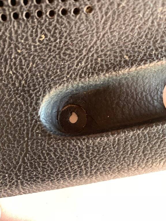

Tiny cracks by the bolt holes.

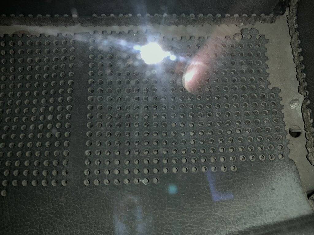

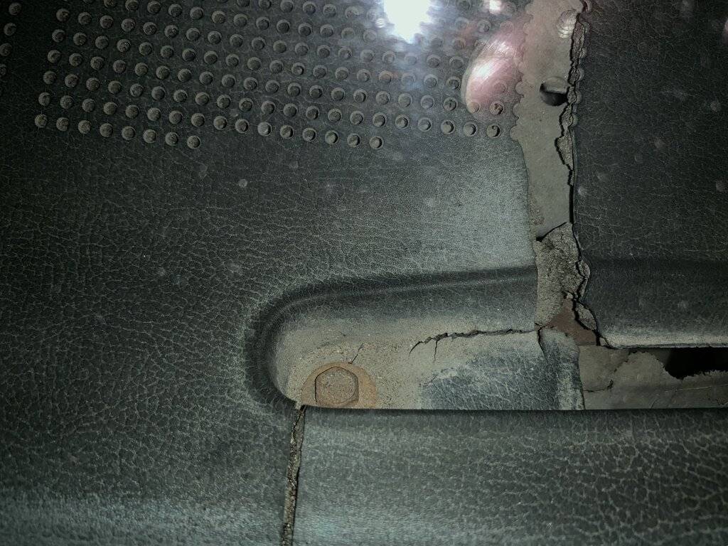

Here’s the mess on the underside. I have no need for the under dash speaker so it’s getting evicted.
personally, i would try krazy glue on the small cracks around the bolt holes. it's naturally going to crack along the weakest (speaker holes) and most stressed areas (defroster vents). not much you can do except keep it conditioned, as was said above.

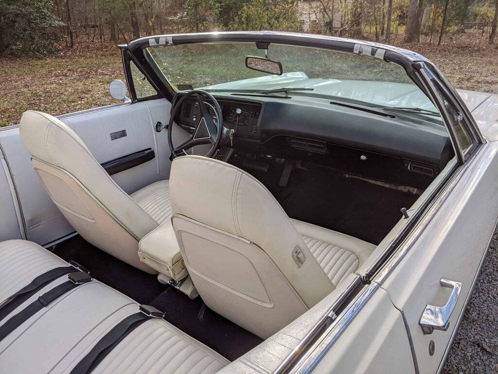

The proof is in the outcome, Ben
Happy 70 Fury

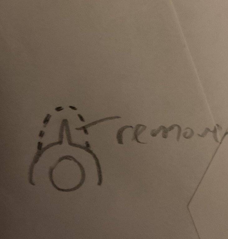

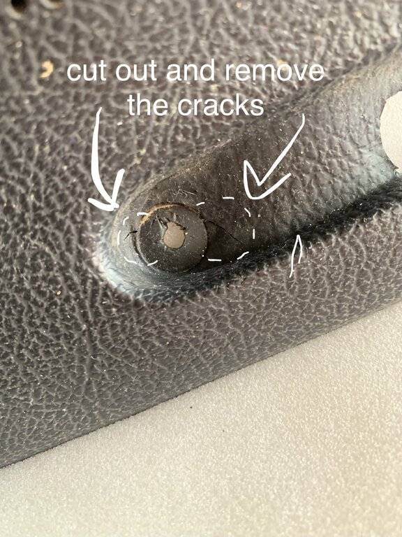

I was going to try and eliminate them by cutting them out or drill burn them to deadhead the crack.
I was also wondering if nylon bolts would prevent the heat build up that starts cracks better than the iron bolts. The pads only 3 or 4 pounds so I don’t think you’d need the strength of iron. Just a thought.
i think you are going to be chasing your tail. the vinyl shrinks overall , it's stressed more at edges whether a factory edge or one you created. if anything , maybe rubber washers to cut down on the stress of the sharp edge of the metal bolts/washers.

You and Mr Fury440 have always been my inspiration to get my dash up to snuff. Yours and the one in his red Fury convertible are beautifully presented. 10 out of 10 sir!!!!

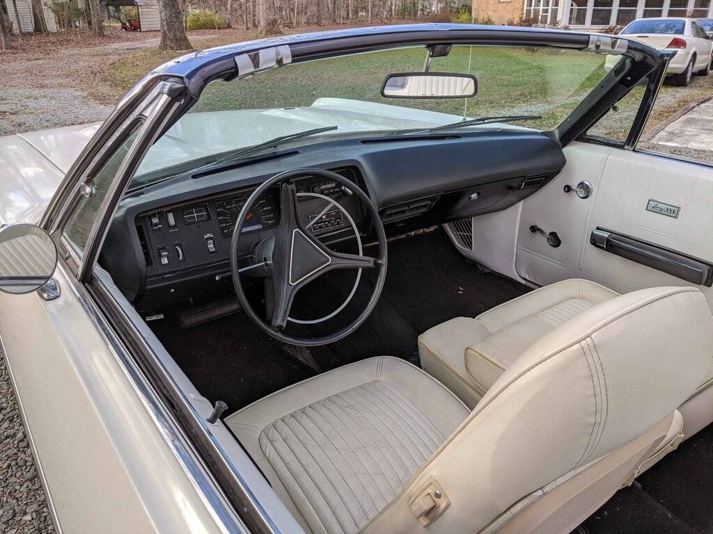

My dash has lasted 4 years.
#1 The car is garage kept. Shade is KEY. There is no better shade than a garage.
#2 Once you've got the vinyl softened, apply the Meguiar's at least once every 3 months to keep it that way. More, the more you drive the car. I put less than 1000 miles a year on mine, so extrapolate.
Bottom line: I believe you can make a dash that has no cracks soft and then keep the vinyl soft. I admit, it took over a month (maybe 45 days) to get mine soft, but what's so little time in the life of a 50 year old car? And who's going to notice tiny cracks at screw holes that can't expand because the rest of the dash is OK? Just my 2 cents, Ben

We tried glues etc back in the day but once a crack started you were toast. And good luck finding a good one in Phoenix. Back in the 80’s you had a nice dash or a dash matt. It doesn’t get that hot out here but the car is no show pony. It sits in the sun for hours at a time sometimes all day. I was just thinking if I cut out the crack where it doesn’t even matter then with the softener I could put off the inevitable for a good long time.
