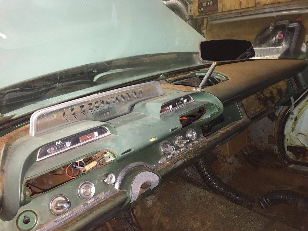

I had some time and removed the dashboard in order to clean things up

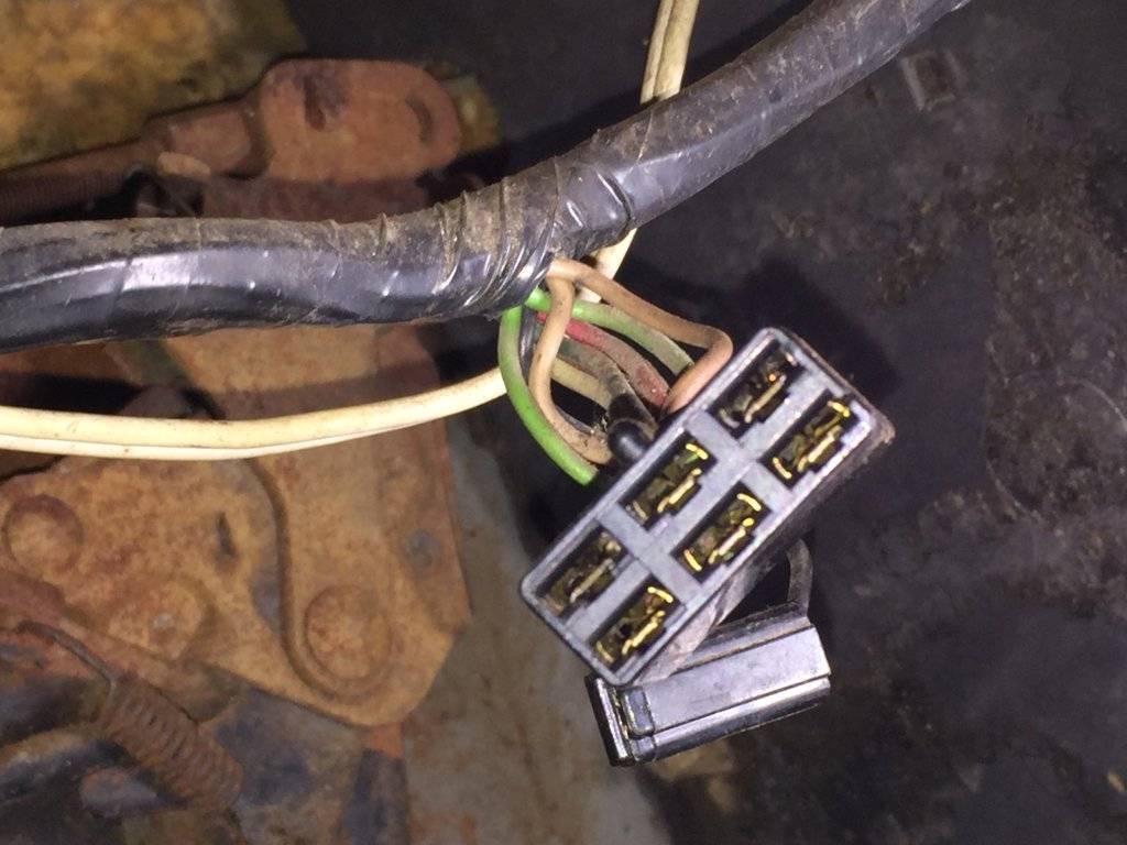

The harness is in rough shape under the hood n better in the cabin but still in need of serious attention

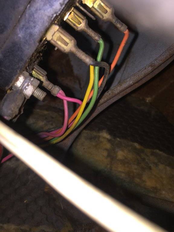

The headlight switch wiring was almost non existent and wired incorrectly

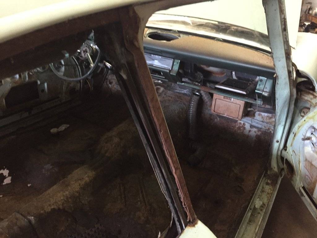

The one shot is after the dash was removed

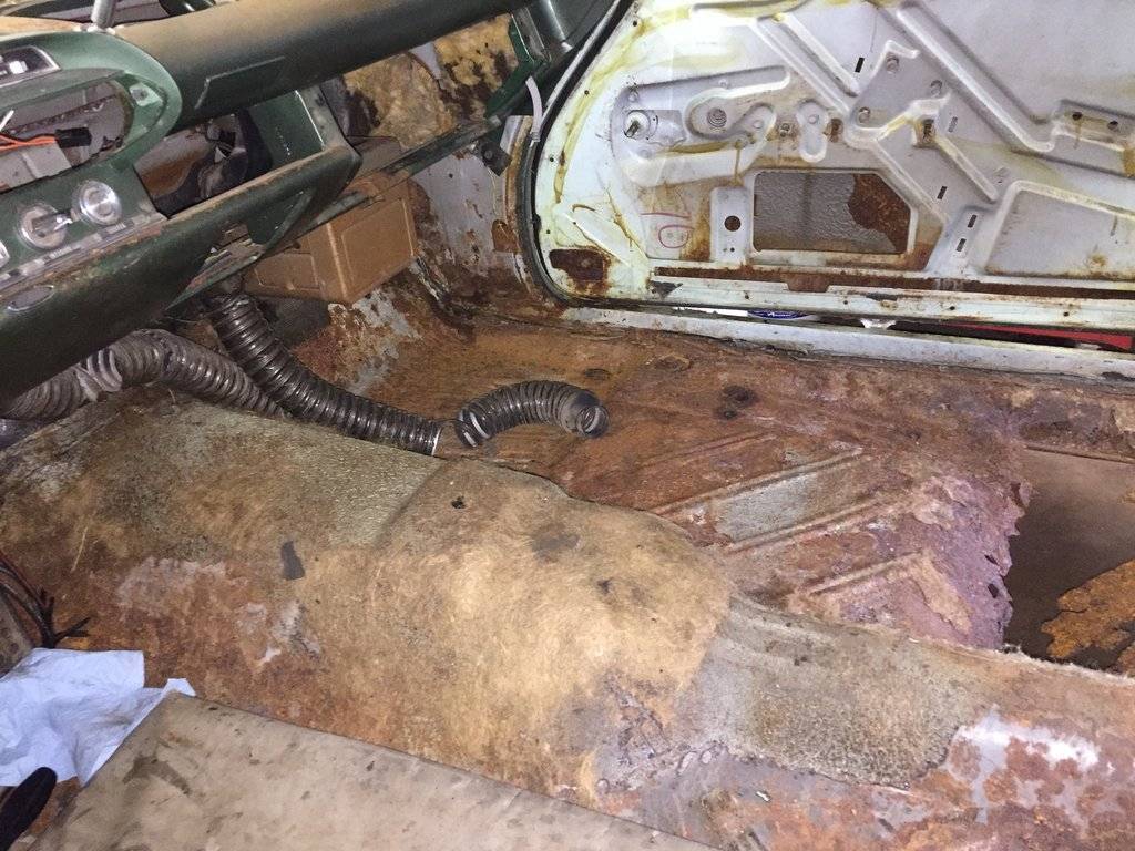

There is some major surface rust happening here so it's good thing I am rescuing this beast:p
