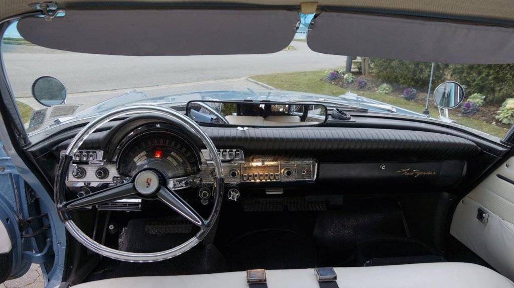

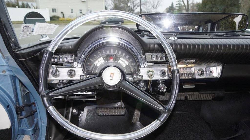

    I love everything about our '67 newport and 300. The thing I can not stand is the dash and gauges. I want something more modern looking. Is there another dash from another molar the would swap? Or would this need to be a custom build? I would like just a flat dash that is inset just a bit from the edge of the dash pad.

    In the time frame those cars were designed in, it was the basic orientation that should the occupant's head be forced forward in a collision, it would contact the padded dash pad rather than the instrument panel itself. Hence, the "top ledge" of Chrysler instrument panels from '65+. A part of the safety equipment of that era.
    There might be some Dakota Digital items that you could adapt to the existing panel? But anything would have to be fully custom, I suspect. Their plug-in kits for the '71-78 Camaros are about $700.00+ at Summit, for reference. A '67 Chevelle item might be close enough in basic size, but would still need a full adaptation. Be aware, too, of what is behind the instrument panel that you see. Radio, hvac case and ducting, etc.
    What might be more doable is a complete instrument panel assy from a similar model year Dodge Polara/Monaco. It MIGHT bolt in as a complete assembly, wiring and all? Might check the contours of the door panels where they might meet the dash panel itself?

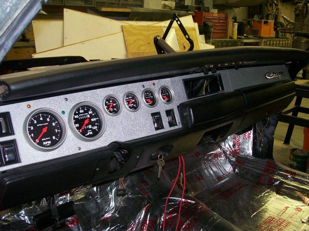

    In my search I found this, I believe its a 68 charger dash.I don't care for the gauge layout, i have another orientation in mind but the angle and flatness of the area the gauges mount to is what I am after. What other cars would have this same style dash?

    The aforementioned Charger, or any B body with the ralleye dash.

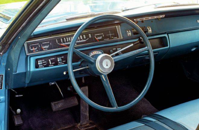

    There is also this dash which is the standard "B"body dash for '68, '69, ''70 ...
