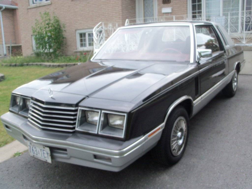

Brian.Despite having owned a K car myself,It was carbureted and sold it 3 years ago.
However,I did frequent the K car club forum often when I had my SuperK (My screen name there LOL)
Very helpfull people there..
The Chrysler K-Car Club • Index page
Hope this helps.
