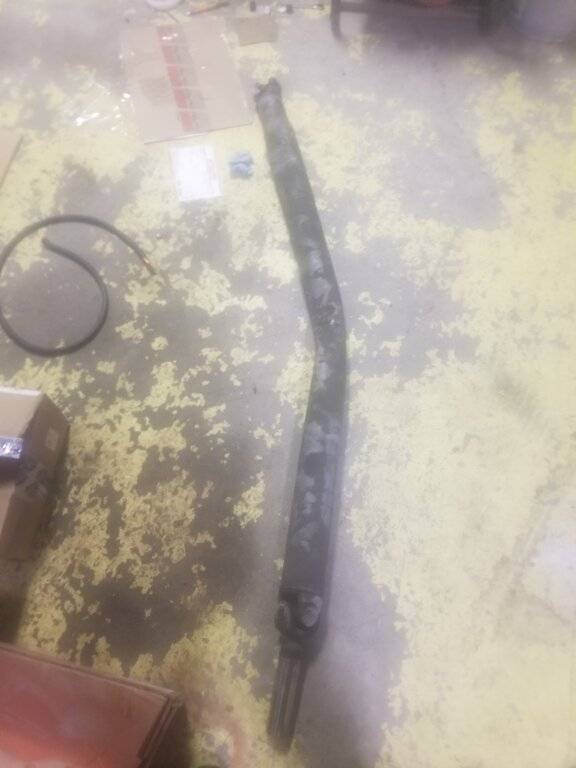

    How's it going everyone. It's been a few years since I was last here but I'm back with a bit of a dumb question I guess. I bought a 73 fury alittle while ago. Finally been driving it for a few months and fixing little things here and there. So I was cruising today and a bowtie pulled up next to me. We decided we should run em and well I destroyed my driveshaft. Looks like a bolt on one of the u joint straps was loose and the strap came apart. We were already at speed and while I was slowing down the driveshaft came out of the transmission and I ran it over. Lucky for me it didn't take anything else out. My question for you guys is, when I put the car in park I can hear what almost sounds like the park pawl grinding. Drive and reverse appear to work I got the car up on jack stands and put it in gear and I can see the splines at the rear turning. So my question is did I destroy the transmission too? Should I just take a look inside and see what comes out? Also any advice on where I can look for a transmission, driveshaft, and pinion yoke for my differential? This is a 360, Small block 727, 8 1/4 diff car. I can't really measure the driveshaft to get a new one made on account of it being bent. I appreciate any and all help from you guys. Been a few years since I was last here. My first experience with a c body was my 68 fury I bought when I was around 20 years old. About 4 years ago. Maybe longer actually.

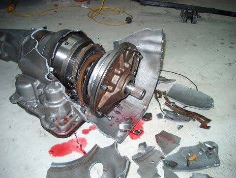

    Check the tail shaft housing to make sure you didn't break it. Park SHOULD have engaged once you shut the engine off.
    If it's making noise after you restart it in Park, check to see if the output shaft is turning. If it isn't, I would suspect you have taken out the overrunning clutch or sprag if it was still in first when it spit out the drive shaft. A driveline or diff failure when on it in first with the shifter in D or doing a burnout in D and having it hook hard when you get off it can and will roll the the sprag.
    A telltale sign of a failed sprag after a driveline failure is putting it in drive and it doesn't seem to want to engage unless you rev it up a little.
    If you get on it after that the sprag can fail completely and cause a front drum explosion.
    You don't want to be around that...
    KABOOM! This 'Cuda's Transmission Explosion Ventilated Just About Everything In The Car - BangShift.com

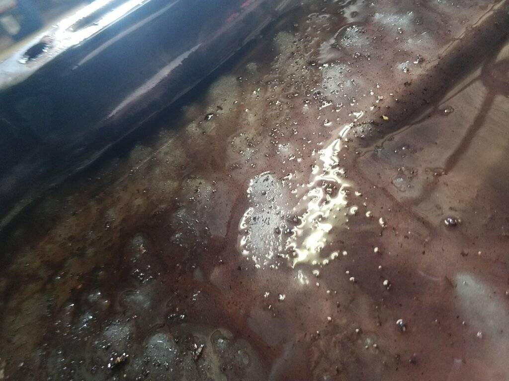

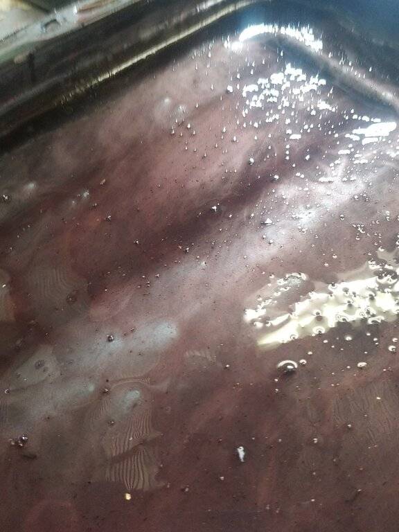

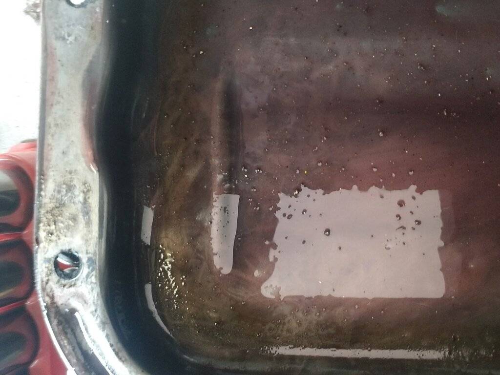

    20200927_145115.jpg 20200927_145019.jpg this is what the pan looks like, there isnt any huge pieces in there but it still looks like too much for me to trust it. What do you guys think?

    Like I said I'd want to make sure the case isn't cracked on top. And the tailshaft assembly is ok
    Might not be any pieces in the pan...yet

    you shouldn't have chunks in there. normal wear would be grey sludge on the bottom of the pan. looks like it's time to pull it and check closer.

    Sounds like a plan I'll pull the transmission out tomorrow when I grab some tools from work
