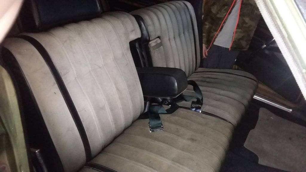

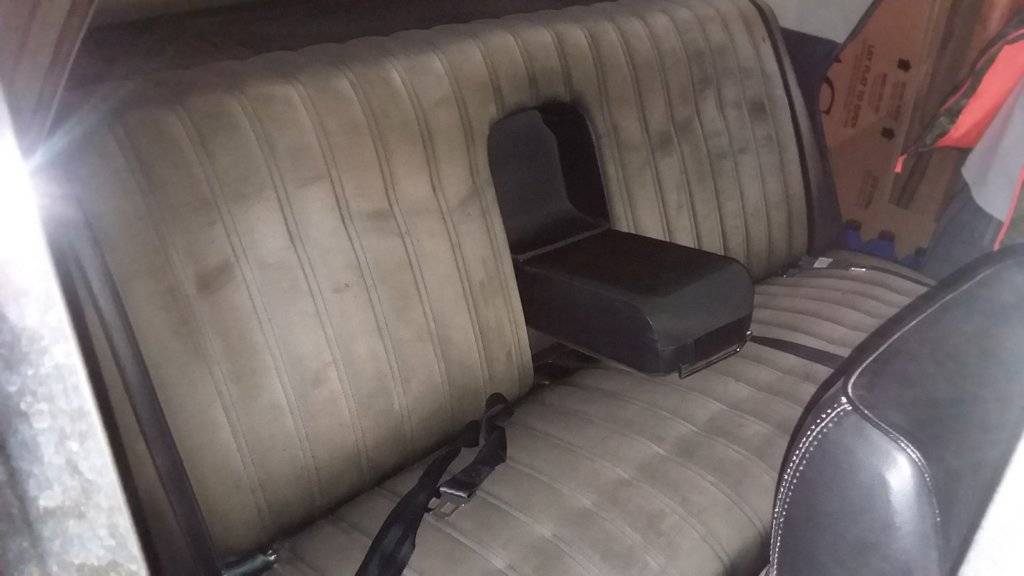

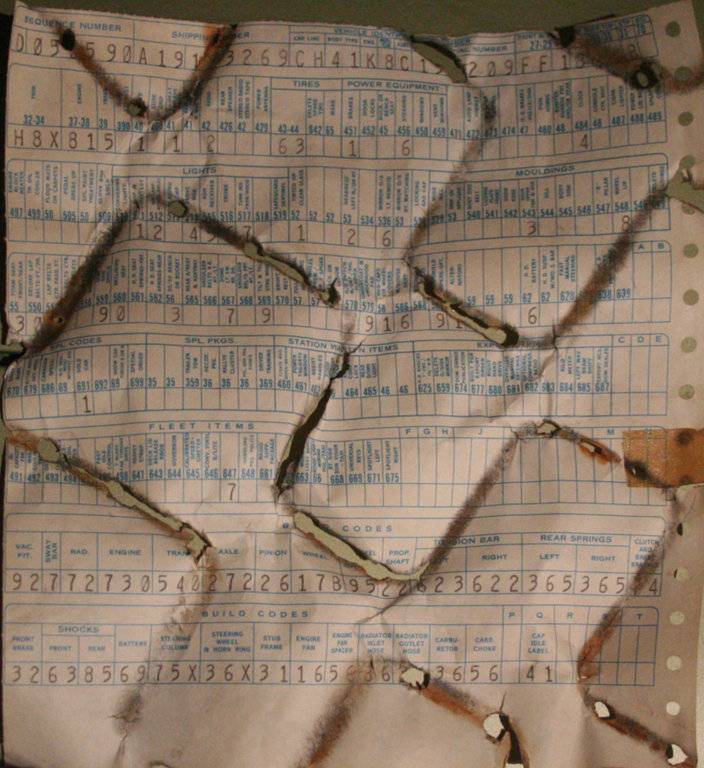

Well, I think I know what the color should be, but I've reviewed the build sheet and if the information is there I don't know what I'm looking for. This is on my 68 Chrysler New Yorker. The paint and style code is FF1 which is Frost Green Metallic.
I'm certain that the vinyl is black and I'm pretty sure the cloth should be also. I think the cloth should be black because when you put the armrest down it's black.

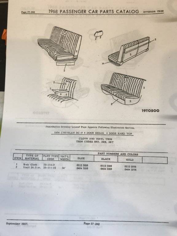

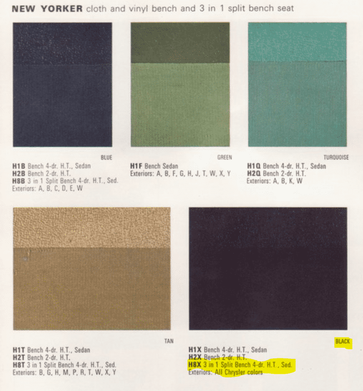

Here is the style and where each color goes from the ‘68 parts book.
Thank you so much. It certainly helps if you know what you're looking at and I clearly didn't.

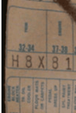

Thanks but it was actually easier then it seemed. Mopar interior codes were always three character Letter, Number, letter and X is always black.
The Hamtramck Historical library is great — the link above shows that:
H8X: black vinyl and cloth
H9X: all black vinyl
And high trim in both cases (3-in-1 split bench)

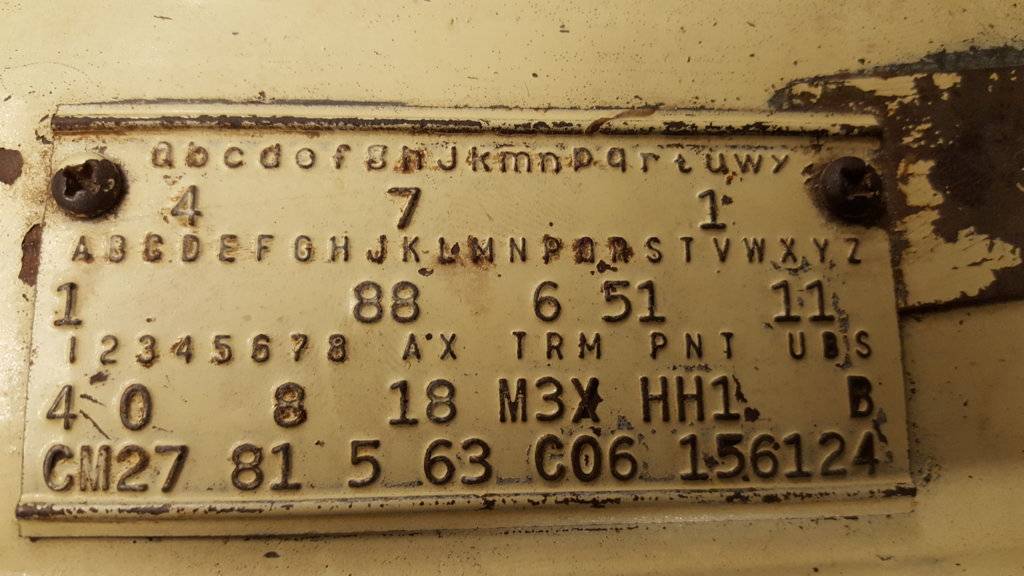

It is also on your fender tag on the third line , TRM which on mine shows M3X which is black leather next is your paint color PNT, mine shows HH1: Antique Ivory
