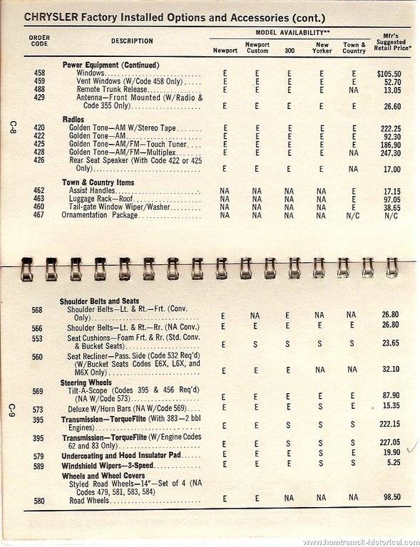

Did the 68 300 convertable get multiple rear speakers when equiped w/ the stereo radio?
Can't help you out, I didn't even realize that a stereo was an option in '68. A simple FM radio was pretty rare in '66.
No rear seat speaker with the stereo option. Code 426 only available with 422 or 425
Ah, ok. So with stereo system no rear speaker at all. That'd would be a bummer! Though not that the single center speaker in our 300 vert is anything to write home about.

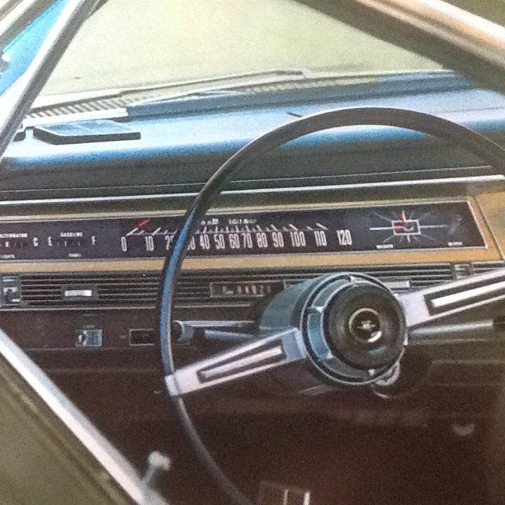

My '68 300 vert came with AM/FM search tune radio with the floor button near the high beam switch, front and center rear speaker with a fade switch. The catalogue states there is a AM/FM Multiplex radio. With up to 5 speakers. "Up to". Maybe if the stereo option was available on a convertible, it came with 4? 3 on the dash, one in the center of the seat. The posted picture of the '68 300 dash from the catalogue, it shows how the stereo speakers were mounted to the dash.
1968 was the first year for Chrysler multiplex AM/FM radios in C-bodies. The "base" speaker set-up would have been the center front speaker and two other speakers, one on each side of the upper instrument panel (as pictured). A right channel, left channel, and derived center channel.
As the convertibles only had the provision for the center rear speaker and no side trim panel speakers, it would make sense for NO rear speakers on the multiplex-equipped convertibles, just the three front speakers.
In the case of the closed cars (sedans and hardtops), the three front speakers were joined by a pair of rear speakers, which were connected through a dual-channel fader mechanism. Same basic configuration that was used until the 1974 C-bodies came out.
The AM/FM Search-Tuner radio, which would be "mono" only, would have had the normal center front and center rear speakers with a front/rear fader. On the closed cars, it would probably have used the rear deck location? But it would have been easy to wire in two 6x9 package tray panel rear speakers instead of just one. On the cars without the rear seat heater. Being there were two 6x9 holes already back there.
