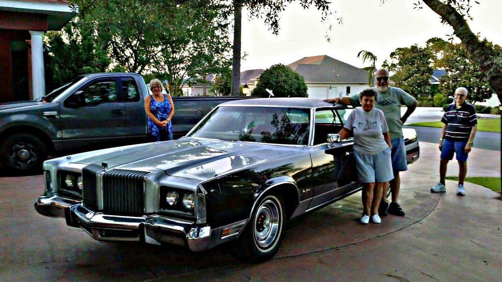

Bob, you are forgetting that my NYB was ordered without a vinyl roof and was delivered as such The lady who ordered it chose not to get the factory vinyl because she didn't like the colors so she instead had the dealer install one with the color of her choosing.
Also remember she now lives in my town and I can get a sworn affadavit if necessary. Lmao...
I'm standing with Annie who ordered the car in 1975 and whom I bought it from.

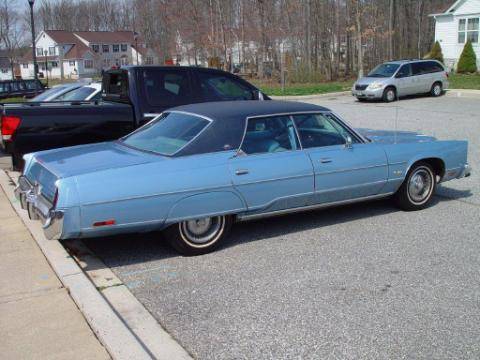

The present condition of my 78 NYB would be so much better if it didn't have that damn vinyl. It is suppose to be blue but has deteriorated so much it looks black.
