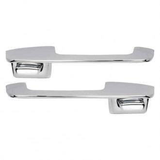

They should be the same part as used on A, B and C-bodies from 1967 - '73; you would need to specify right or left side. I pulled this image from carid.com:
Sometimes you have to swap you existing push button and linkage over to the replacement door handles especially for the rear doors.

Not sure about that ... The parts manual for '70 and '71 cars show a different part number for each car line and year.
