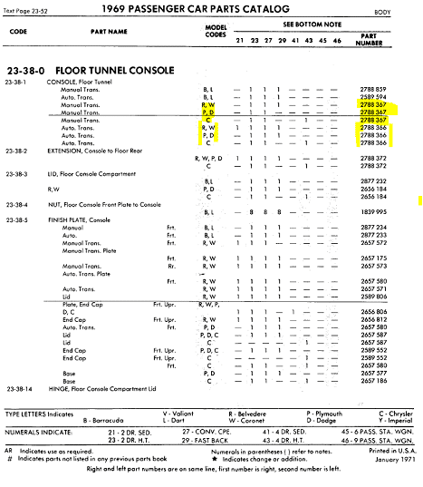

I've always suspected they were the same but never had the need to look. I just checked the 69 parts manual and they are the same for B and C bodies but different for A bodies. There is a difference between Auto and Manual trans also.
A body Barracuda and Dart are unique part numbers but B and C are the same part number. The one from the B body should work fine.

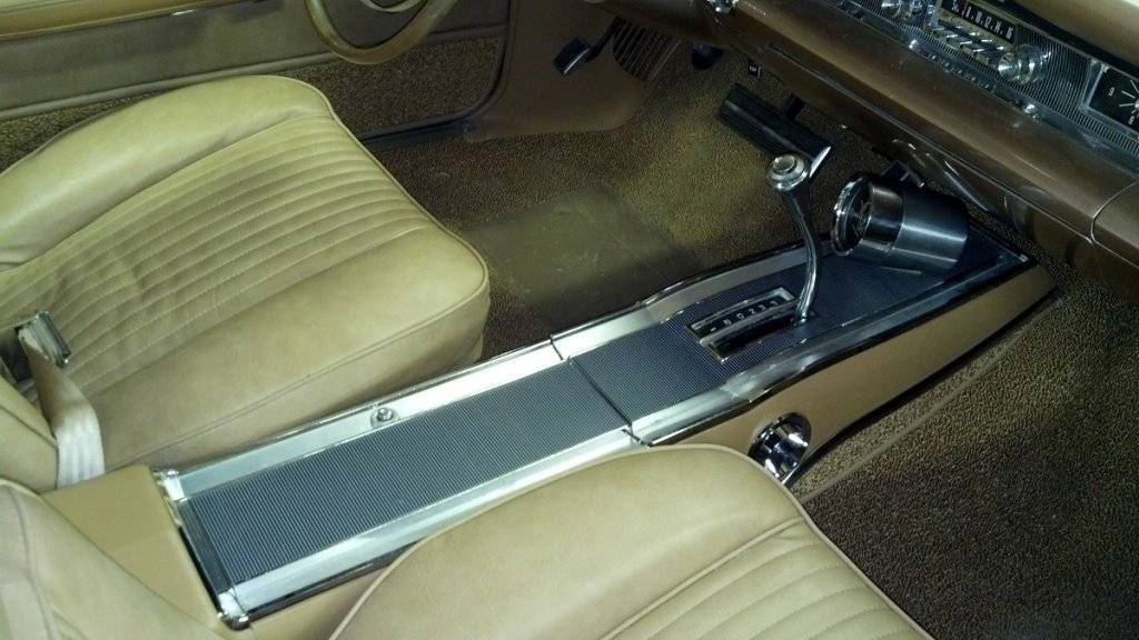

I know for my '66 300 the lid and top are the same structure, but on my 300 the background is painted black, but it is all chrome in the B or the repop.

Very pretty. I learned something new. Didn't know they were painted in 300's. Do you know if all C bodies with that finish were painted?
I'll ask my friend to take a peek at the one he pulled out of a 68 300. Never even thought about it.

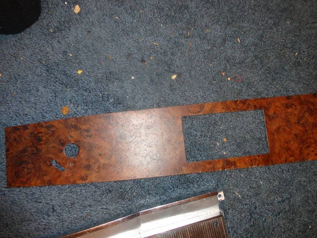

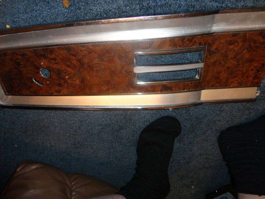

The console out of the 68 300 has wood style tops. I need to find out what top I should have in a 66 Polara, smooth or ribbed. I only have one pic of a 66 Polara and it's small and grainy so it doesn't help. Looks smooth but can't be sure. I have a pic of a 66 Monaco 500 and it is a smooth top. See what I find with more digging.
I would love to have the wood one back in my 68. I put a new 67 ribbed one in because no one makes the correct 68 one. I kept my original on in the hope someone will reproduce the inlay. I bought the a "new" b body chrome one. Looks great but bugs me wasn't the correct one. However there are so many thing changed on my car guess it really doesn't matter.
I'll have to find the correct ribbed top plates, but I'll have 2 sets of the simulated wood tops to sell.

I actually tried to restore mine first and failed miserably. The problem was the ribs where really beat up, so you couldn't get clean black shadow lines.

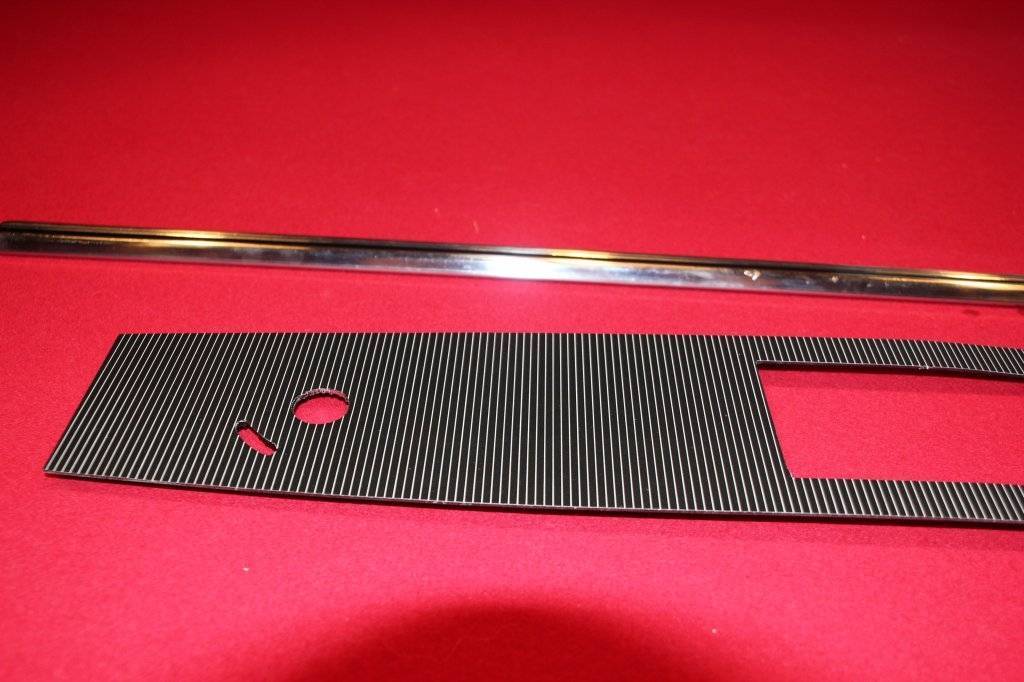

Everything I've found for my 66 Polara shows a smooth silver top with a painted black outer lip. Are the tops with the wood applique smooth under the wood, and can I easily remove the wood with a heat gun and nylon scrapper? Or is the smooth silver section an insert as well, and that is what I need? Both my tops with wood have the holes for a vacuum gauge (or whatever gauge) cast/drilled in them, that's what got me thinking about the silver being an insert. I have a number for the top but can't remember it and won't be able to get it til tomorrow.
does it look like this? look close at the pattern
