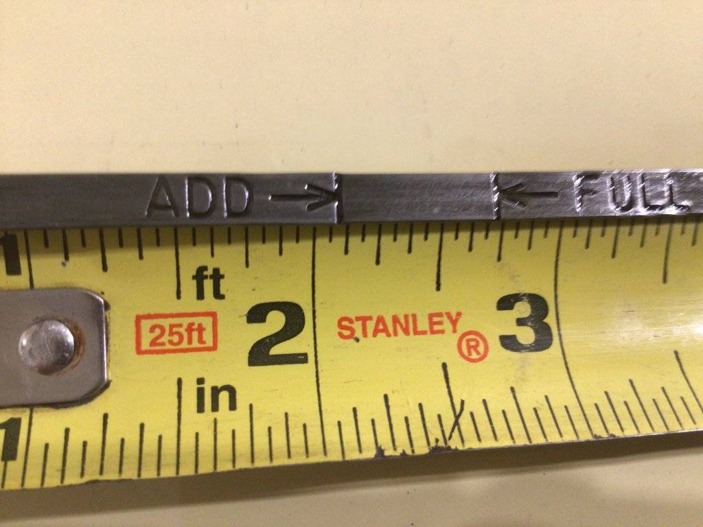

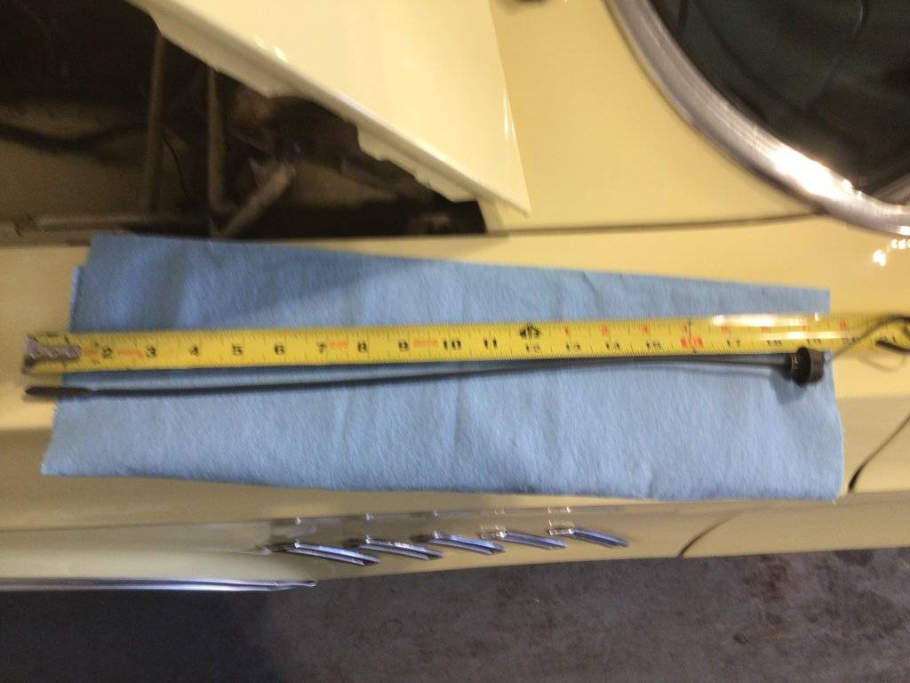

Took a photo of my dip stick for you for your search. Add line is at
2 1/16 inches and full is at 2 3/4 inches from the tip. Hope this helps. Jim

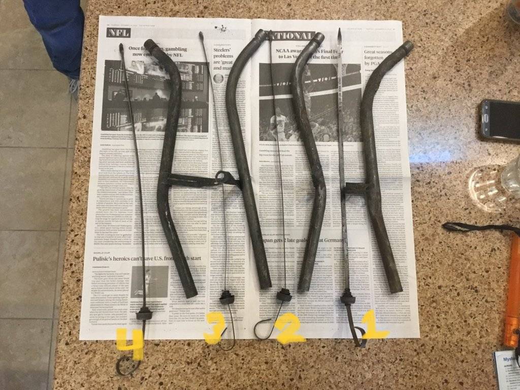

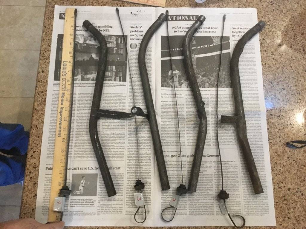

OP: I have several original dipsticks in the parts collection. I will be able to go through them over the Thanksgiving holiday if you can wait that long. To confirm you are looking for 383 engine and not for the 727 T correct? I have both (I think). All the best, Retroman.
Hey Retroman, I have a 68 300, has 440 motor with 727 torgueflight. I need the trans dipstick. If you have one let me know when you can. Thanks.

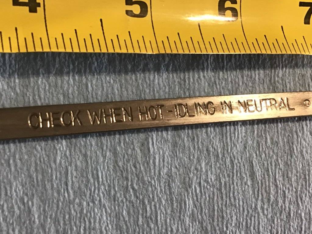

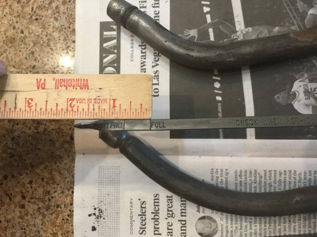

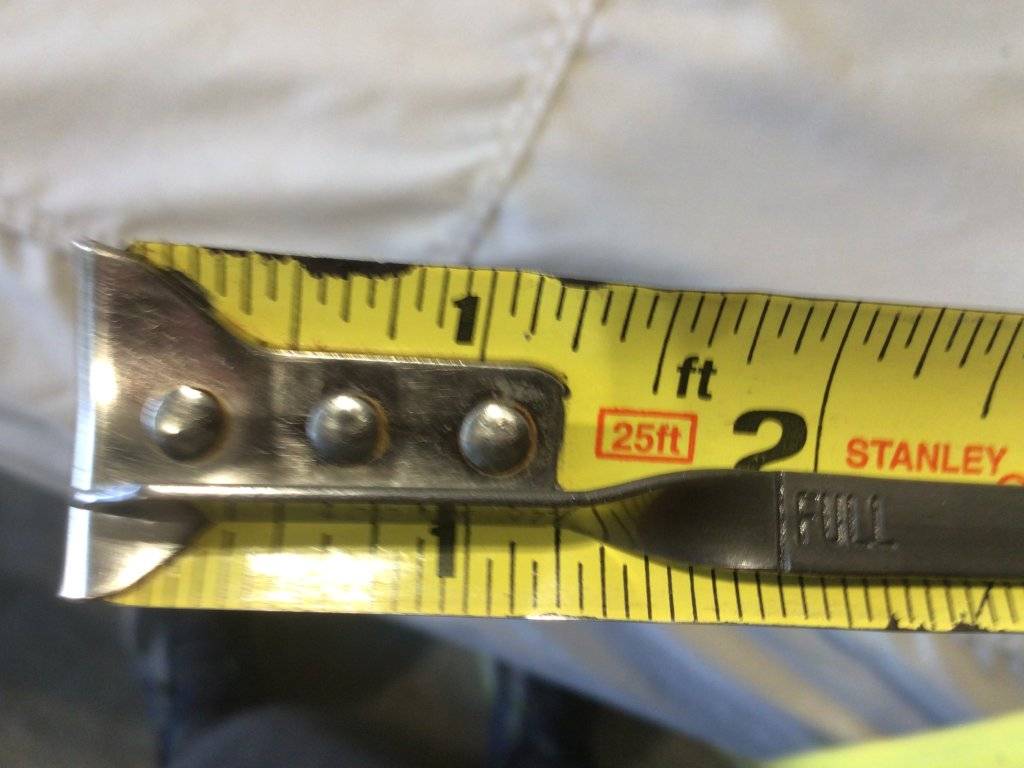

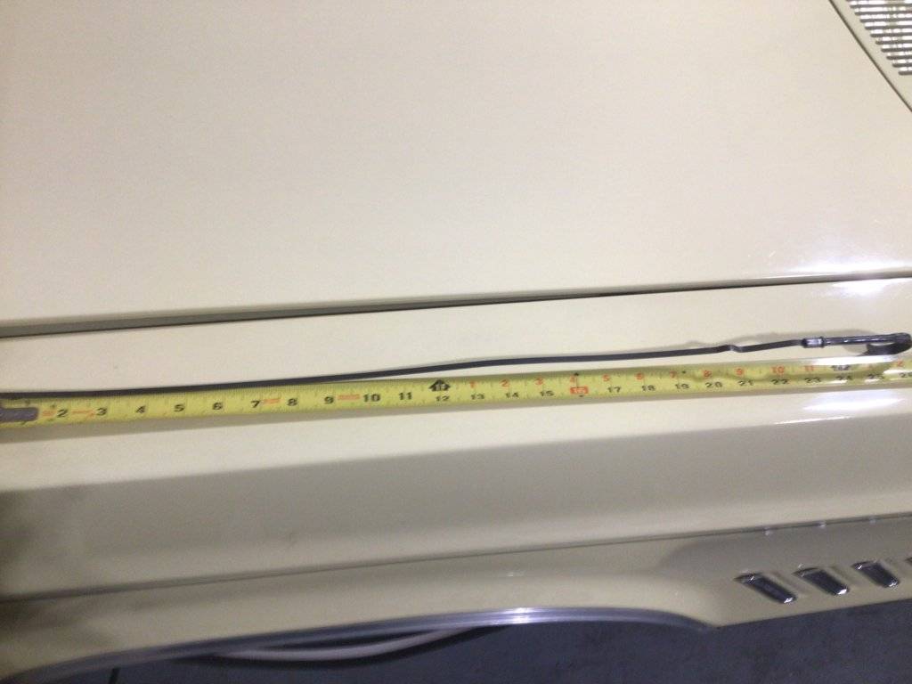

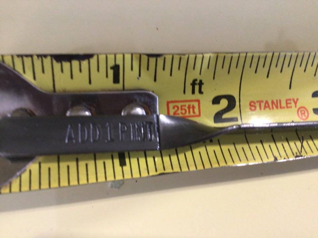

sorry , didn’t get back out in the garage to take a picture of the trans dip stick until today, the lower measurement reads add 1 pint at 1 1/4 inches from the tip, full at 1 7/8 inches from the tip.
The body of the dip stick reads: Check when hot-idling in neutral.
This is because the trans fluid is not circulated in park.
This is because the trans fluid is not circulated in park. View attachment 568151View attachment 568157View attachment 568158View attachment 568159View attachment 568157View attachment 568158

Carguy300: These match the one from our 66 Newport 727. Your choice with tube $60. They all measure the same. All the best Retroman
