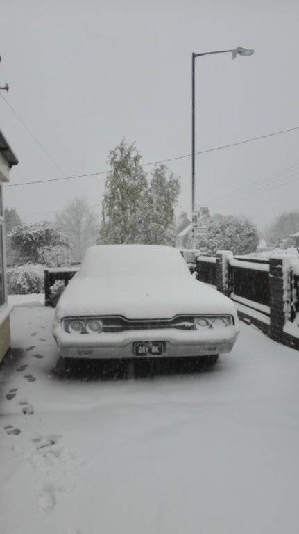

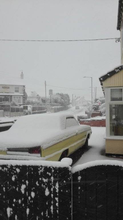

    ps snow has just hit here, i'm stuck indoors just had right knee replaced....missing all the fun, polara, snow, drum brakes...what could go wrong!
