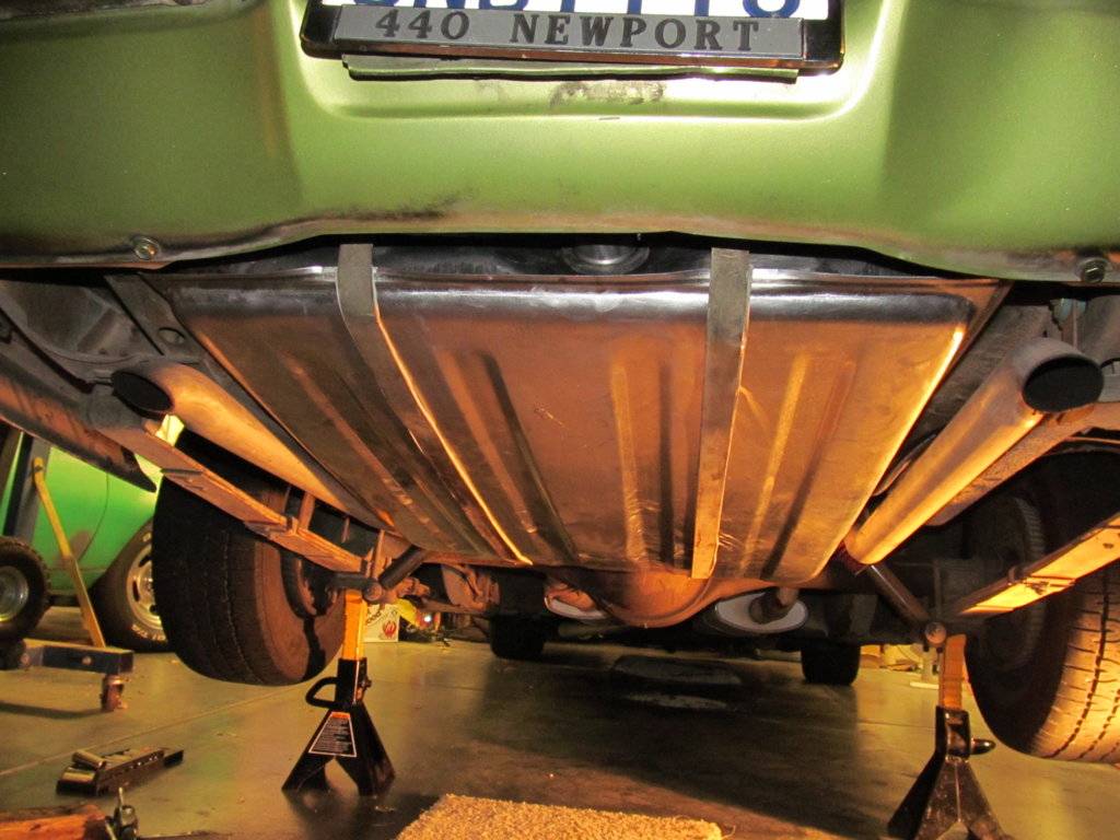

    also need a new gas tank? any sources, thanks

    If you do a web search for '70 Chrysler Fuel tank, several vendors come up. www.partsgeek.com has them among others.

    Like many, I put a CR9 gas tank for a B-body (~1968 Charger) in my 65 Newport last Fall. There are several year choices w/ various 1/4" vent tubes. Cost ~$100 vs ~$300 for a new C-body tank. I don't recall any fit issues. I dealt w/ more since plumbing a return tube for fuel injection.
