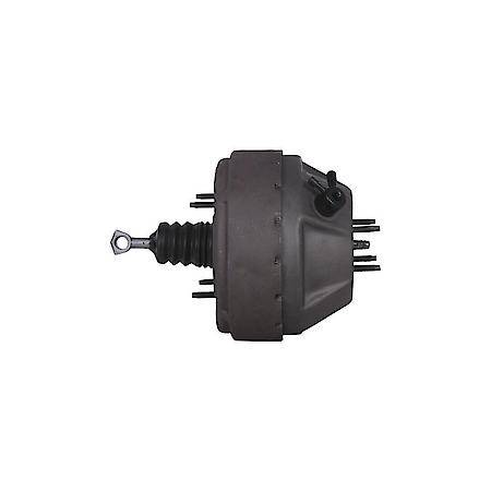

    Doing the disc conversion on my 66 300 this winter and was assembling parts. down to the last couple. I cant seem to find a dual diaphragm booster (bendix style in photo). I have column shift.
    I would love to get the booster and MC together but cant seem to find them (as a pair) in stock anywhere.
    1- is a single diaphragm going to do the job. I am only doing front disc.
    2- Anyone know a source outside of advanced,oriley,rock,napa,autozone to get something like this?

    Referencing the picture from my first post- is there any difference in outside appearance between the double and single for the Bendix style booster?

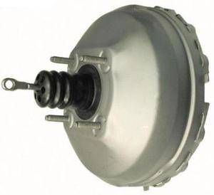

    Yes. The regular drum booster looks like this:

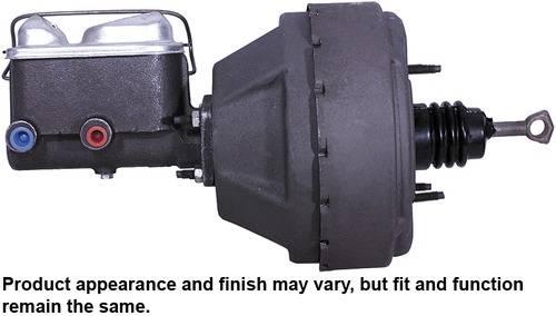

    The unit with the MC is labeled as a dual diaphragm (out of stock). the unit without is labeled as a single diaphragm. Wondering if they are just mislabeled and actually are the same thing.
    Should there be an outside appearance difference between these two if in fact they are different when it comes to dual/single diaphragm?

    Both of these boosters look like dual diaphragm units to me.

    If it is a dual res MC then it is only 166.00 from Autozone. including the 50.00 Core-
