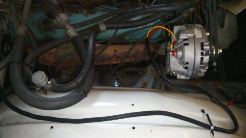

After a study off the electric wires in the engine compartment i found a "home made" solution. The line from Alternator to instrument in dash board was cut before the bulkhead and connected separatly to instrument, and that line was broken somwere between alt and bulkh. A new line there and the Dodge is back......

I put new wires to alternator, better follow the inner fender whit i was thinking, than on the engine.
Nice! I did the same thing last fall when an exposed wire touched bare metal on the upper control arm and fried the fusible link. Nothing like losing all your power -- absolutely everything, while flying down the interstate with traffic...in the left lane. Scared the crap out of me.
