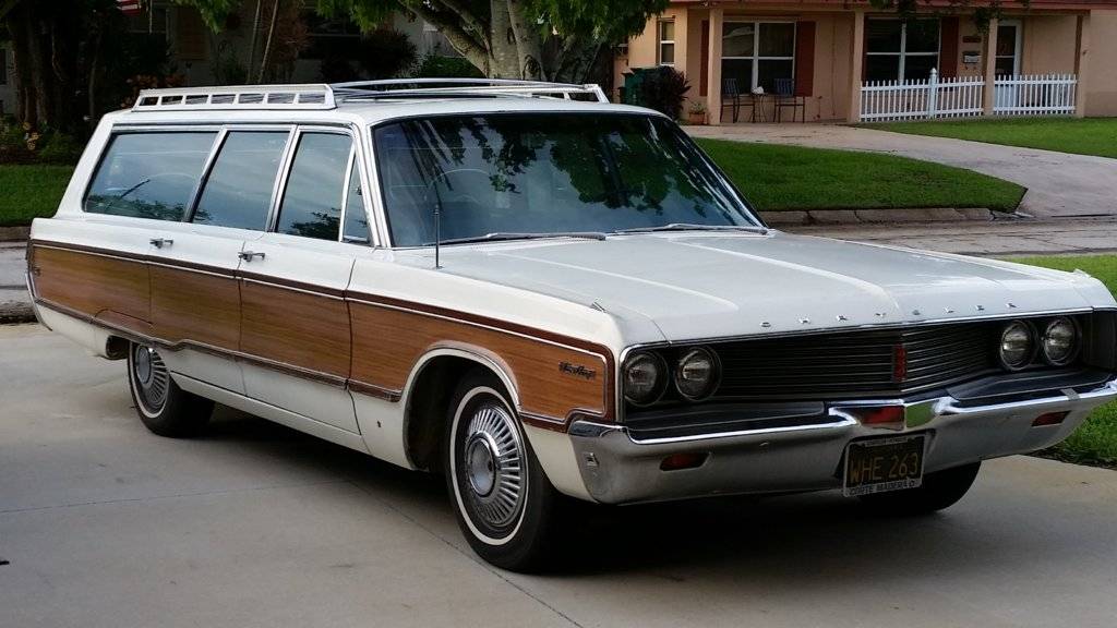

    I am currently working on a 68 T and C with 4 wheel drum brakes, 11 x 3 inch all around. I am considering installing disc brakes and have access to a single piston set up from a 1970 fury. Has anyone done a similar swap? What issues might come up? I am concerned about suspension geometry with the newer spindles, and hydraulic hose lengths and fitment.

    GREAT T&C wagon...… good luck with the swap, and those LOOK like disc brake wheel covers.

    From what I can tell, the outer rings are the same as the Disc brake covers. I will just need to change the centers which denote Chrysler Disc Brakes with a red ring, IIRC.

    I hope yer wheels are 15". . . Huh?

    Hubcaps on his T&C denotes 15 inch.
    Those hubcaps and 15 inch wheels were optional on all models with drum brakes.
    The towing package came with 11X3 drums all around and did not have the self adjuster cables.
    The drums & backing plates are worth some money to a guy building a Hemi Road Runner,Charger,or Super Bee.

    That's right - you could get 15" wheels with DRUM brakes and you got a VERY similar wheelcover with them. Beautiful T&C that looks great with those wheel covers. When the conversion it will stop just as nicely as it looks.

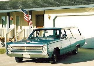

    I am interested in your disc brake conversion project. I have a 1968 Plymouth Custom Suburban Station Wagon with a Trailer Pack (3" x 11" Drums).
    Did you need to change your wheels? I was told by a Mopar fan that the conversion to from Mopar Drum to Mopar Disc brakes requires "wheels designed for disc brakes" for clearance reasons.
    I have the original steel wheels.
    Thank you.

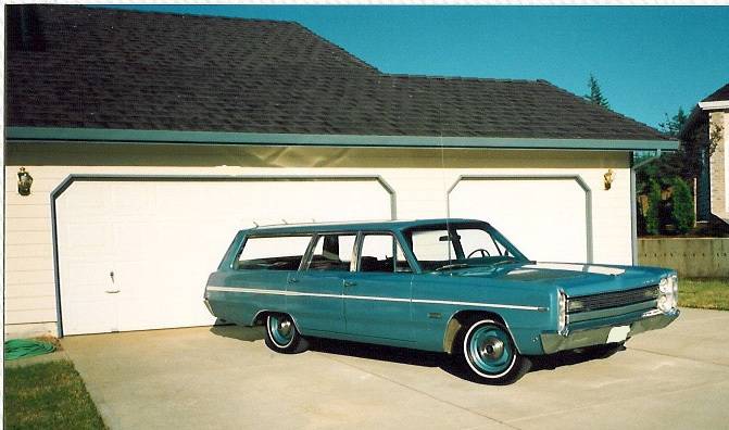

    i Dave,
    I have 15 inch wheels. They are just "standard" steel wheels (a little wider as I have the Trailer Pack option).
    Sounds like the Mopar Disks will fit my car. You can see my wheels better in the picture below.
    Please let me know if I'm missing something. Would be disappointing to do all the work and find my 15" wheels didn't fit. ;-)
