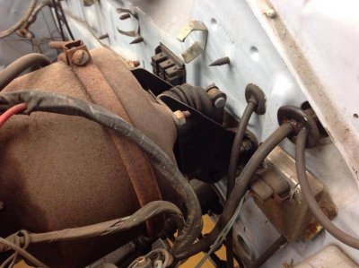

Boosters are hard to get. Good luck finding one that fits at any auto parts. I lucked out and grabbed a new one (Bendix type) for my 65 Newport on rockauto for $70 (clearance). Usually, you must try somewhere like "Booster Dewey" and pay $300. I have not seen rebuild kits. If desperate, you could drill holes to fit another booster to your "booster plate". I had a Midland-Ross booster from a 74 Dart that looked just like the one (replaced once) on my 65 Newport, but the bolt pattern on firewall side was different. I drilled 3 holes and made it work, but one hole was in a rippled area. I later got the correct booster (above) and sold the Dart one. I also tried fixing my original M-R booster. I bought neoprene sheet (ebay) and made a new rubber diaphragm (mine had a hole right @ vac port, though I had used a fuel vapor filter). It works when tested off-car w/ vacuum, but not confident the rubber will last long (haven't installed). Another data point, the booster on a 95-99 Breeze or LH cars has bolts real close to a Dart, since I mounted one on Dart stand-off brackets (photo above) to use on my 65 Dart w/ just a little rat-tail filing. Indeed, they are closer together in width so might have fit better on my Newport's plate. If willing to use A-body stand-off brackets on your C, you can buy a booster w/ MC & brackets for ~$170 on ebay. It uses some GM parts. That would help insure you clear after-market parts (valve cover, headers).
