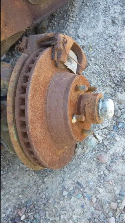

These look rusty, but usable. Disks look like they have plenty meat on them, and are turnable. Calipers look salvageable as well, opinions?
I would use the calipers as cores and have someone mic the rotors to see how thick they are. I am not sure how much would need to be removed to get to virgin metal.
Rotors can be turned a maximum of .060. Have your machine shop Mic them to determine status. Calipers are probably cores. You can rebuild them but as they are a relatively low cost item you might be farther ahead to turn them in for factory rebuilds.

thanxs, all. The .060 or more would be each face, correct. In advance thanks again. If I purchase will also get the proportioning valve, for possible use.
Drum and rotors are the same are the same, max .060. you can go .030 on one side and .030 on the other but no more than .060.

Unless you are having trouble with the portioning valve, I probably would leave it alone. It is a $100 item that does not usually go bad.

Thank you... and just to clarify .060 from new to garbage... don't even bother to cut scale rust... you're unlikely to do anything but dull the bits on the lathe.
I would get a adjustable proportion valve. You can have a lot of pressure to the rear brakes before they lock with all that *** of a station wagon, you want the fronts to lock first or the car will come around on you.
Rebuild the caliper yourself, buy a seal kit and a brand new piston and bleeder then clean the housing out with some good brake clean like red CRC, clean the groove out well put the new seal and piston in and get the dust boot pulled down and you have a rebuilt caliper.

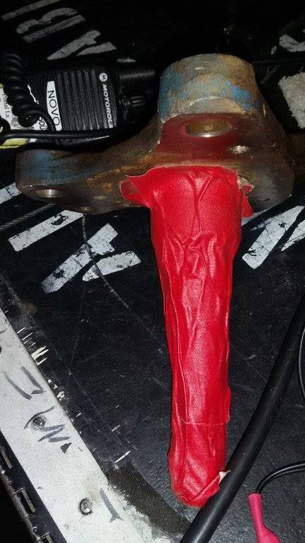

Started on the cleanup of the spindles, curious is the blue paint on the edge of any significance, top of photo. Found it under all the rust and dirt. Second photo less the caliper, preliminary cleaning.
I guessing here, but I suspect the blue paint might be over-spray from body work. Is the car by any chance blue? Spindles look like they are cleaning up real nice.
