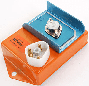

It would probably be best if you determine what you have now.
If it's a Mopar conversion, it will have an ECU mounted somewhere in the engine compartment. It will look something like this:
Might be a different color though.

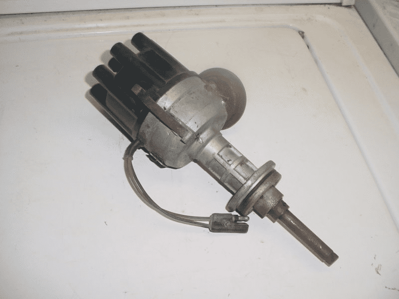

The distributor will have two wires coming out of it with a plug that looks like this:
If you want PM me all the known engine information and the part number on the ECU also.
