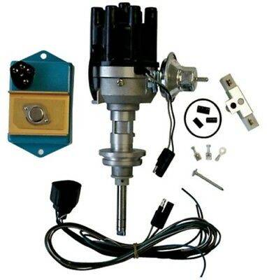

Looking to see if anyone has had experience with Proform 66993 Electronic Conversion Distributor kit,, For 361, 383, 400, etc change from original equipment,, Catfish 65 (Dave)
The main thing is to avoid any unit that is sourced from China, their distributors are **** and so are the electronics. Rich Rhrenberg supplies quality US made units for the conversion. That is what I use. www.ebay.com/str/ricksmopars.

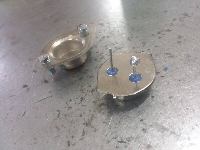

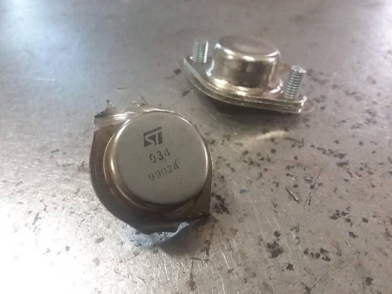

I spotted this on FABO the other day and found it really interesting. The transistor that is mounted to the heatsink and is a familiar part of the Mopar ECM is actually a metal fake part on many of the offshore ECMs.

Holy crap!
:mob:
Think that was mentioned if it is tall it is fake. Look at the markings also on it.
