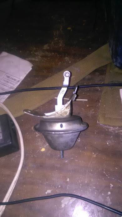

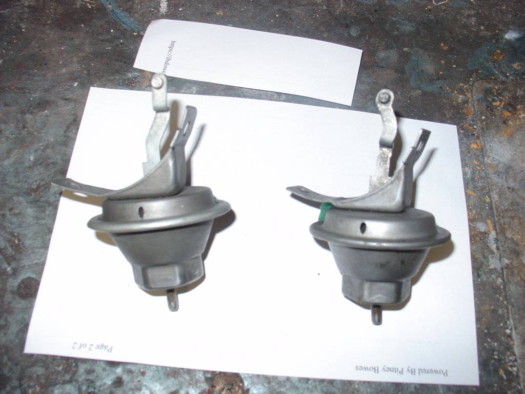

The one on the left! Does the arm have a "9L" on the bottom? I see the one on the right does, but mine definitely matches the one on the left save my old one isn't adjustable. Now, to be SURE, I need to check the one I'm RUNNING.... I'm currently looking at the setup from my old dizzie, which I replaced last year. If that one takes the same thing, we can do a deal.
That number dist above? I can look up the amount needed, the 9L means 18 max at the crank.

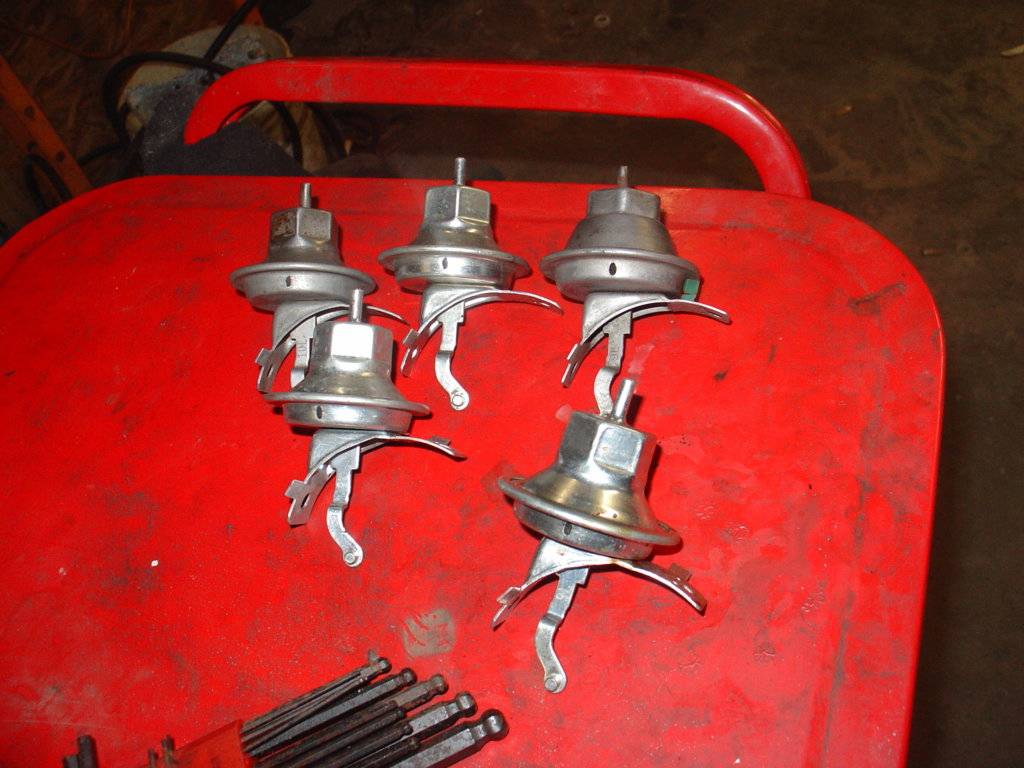

Here is what I have in that style one New Neihoff, non adjustable marked 13, neihoff does total at the crank and two used mopar 3755474, you nsure your distributor is not 2857356? Disregard second pic.

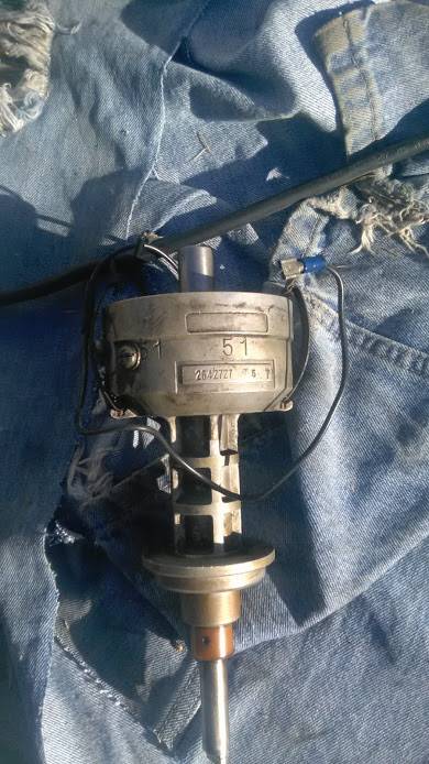

The ARM on the original vac advance matches the arm on the one pictured on the left. The original* distributor is numbered 2642727, which looks to be about right for the mid 1960s as I recall. The body has an oil port, which is nice. The cheap reman from Cardone I bought at VatoZone lacks that, though it works well enough for $38.....

I see what I had came from a '67, if eBay's reference is to be trusted..... 2642727. Looks like 2642244 is what went in the 1966 motors. So long as I can get a little vacuum advance working with this old 383 I'm running, that is all I want.
