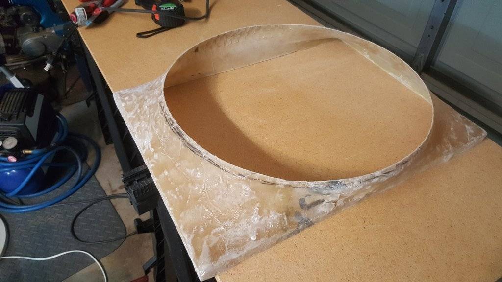

aight - todays instructionals.
flop the rig over, and remove staples:
i finally got the wood form out, with a bunch of spades and flathead screwdrivers and kept going around the form. finally it wiggled loose. the blue painters tape did keep it separated, but was very snug fit.
thickness = good
air bubble = bad
air bubble = really really fknig bad.. kids dont let air bubbles happen. either fix it at the moment, or remove the offending piece and try again.

after trying to decide where 3 1/2" was, and realizing my bike wheel must have been slightly tilted in the form (i hope tilted in the correct direction, i may have to flip it over), i tried measuring all the way around at points, then taping off from point to point. i did this 2 or 3 times and ended up at a different spot each time :/
so then i picked a seam on the bike tire impression and winged it. dremel and cutoff wheel is the weapon of choice.

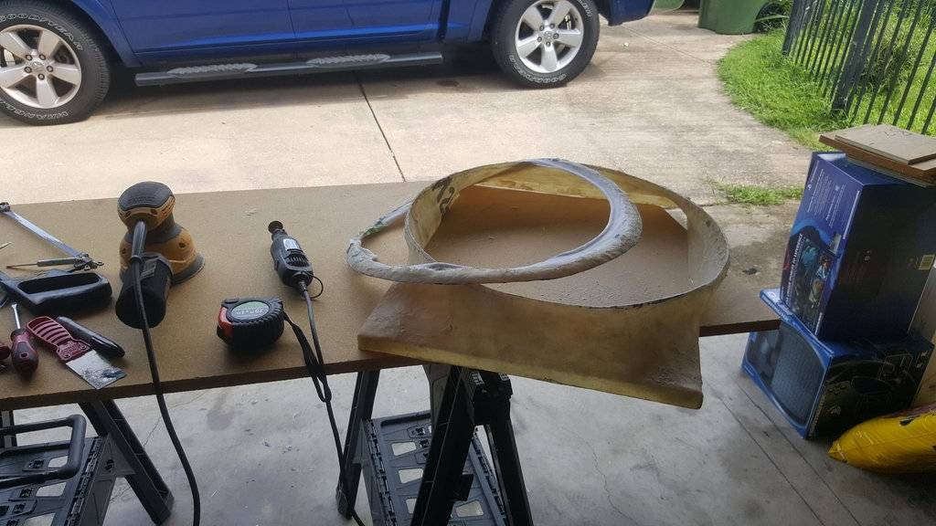

after about the 7th fiberglass paper cut (this shite is sharp on a rough edge) i rough sanded the whole thing. lot of lumps. sigh. but damn if i didnt make a radiator fan shroud.
im going to bondo / pookey / PL30 / something in the inside of each corner. 3 corners are good, but one has a pinhole i can see light thru.
ill head to the store and get some of that there bondo filler goop and we will play some more.

View attachment 131912 after about the 7th fiberglass paper cut (this shite is sharp on a rough edge) i rough sanded the whole thing. lot of lumps. sigh. but damn if i didnt make a radiator fan shroud.
