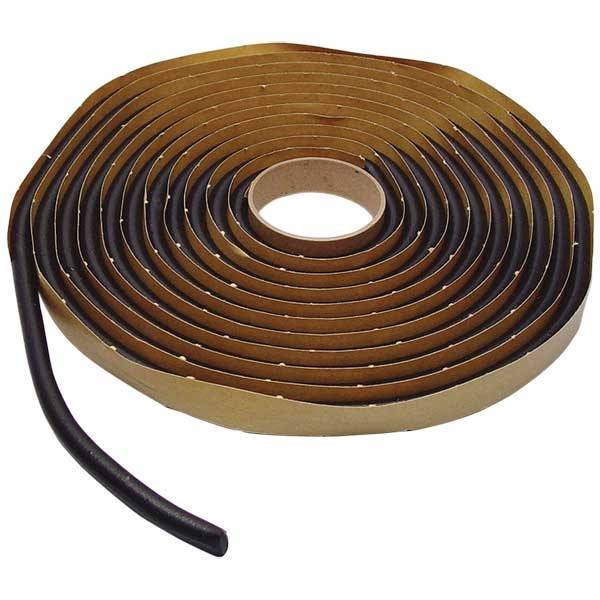

technically not glued. it uses a butyl tape
