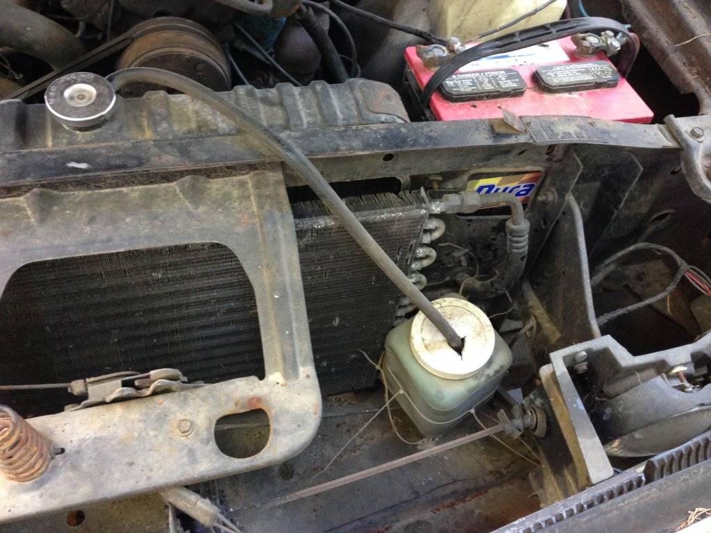

I did on my 67 Imperial. Just rerouted the hose to an inconspicuous plastic bottle near the battery. I found that after a jaunt at 70 mph and a quick shutdown, she would piddle just a tad. Not much, but embarrassing non the less.

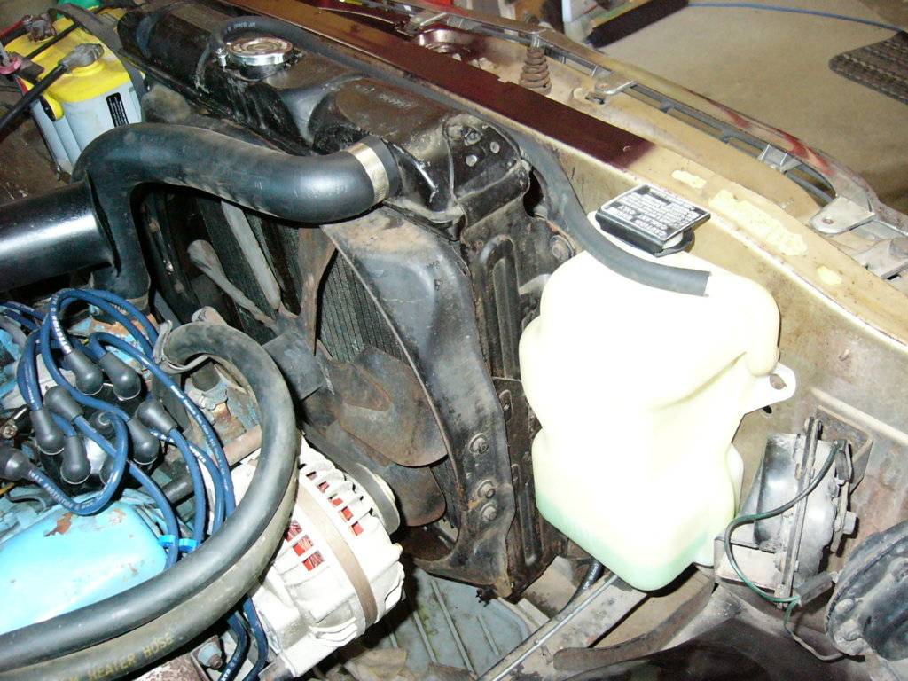

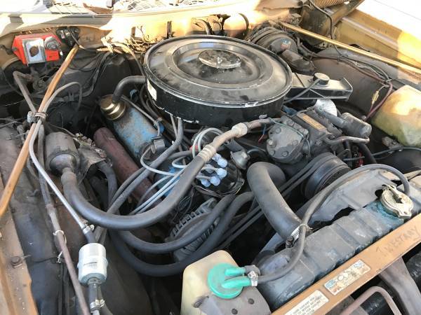

I installed one in my 65. I used an overflow container from an early 80's D100.

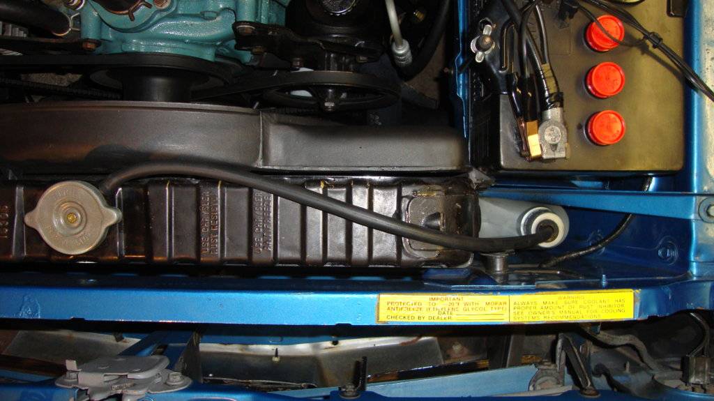

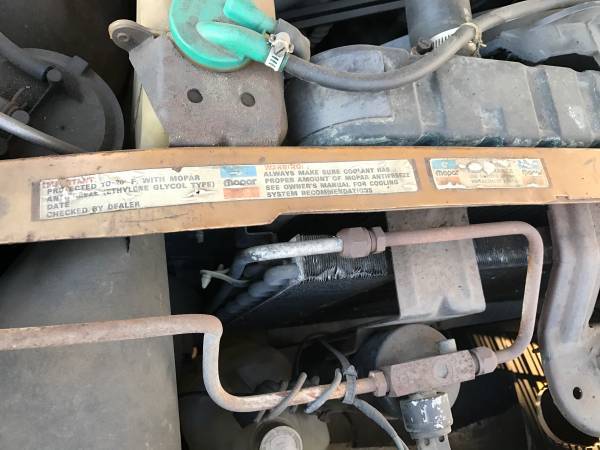

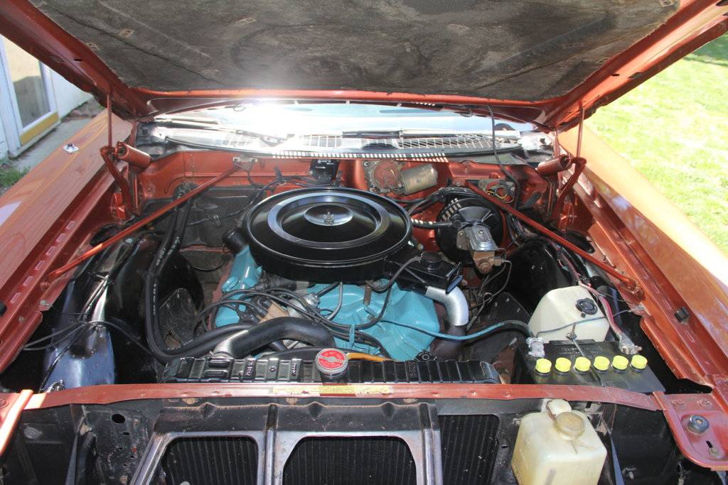

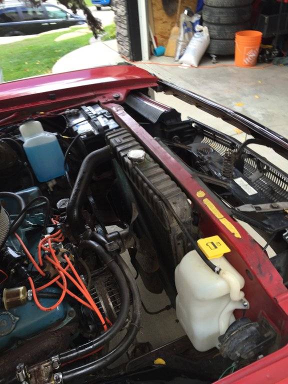

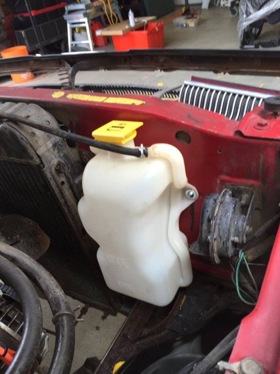

How bout some pics on where you put your catch cans at? I tried to put one in my 68 newport but i haven't found a spot yet

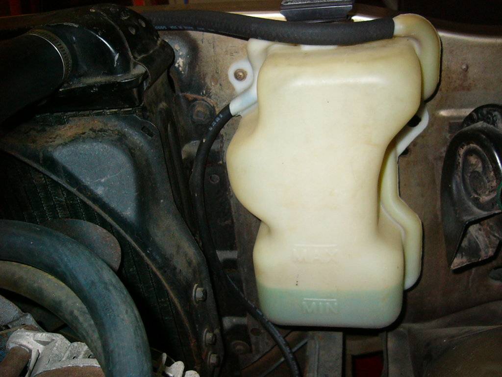

My CHP car has a Cadillac bottle on it, the CHP added them as needed. It was mounted behind the headlight, tight fit but it is there.
