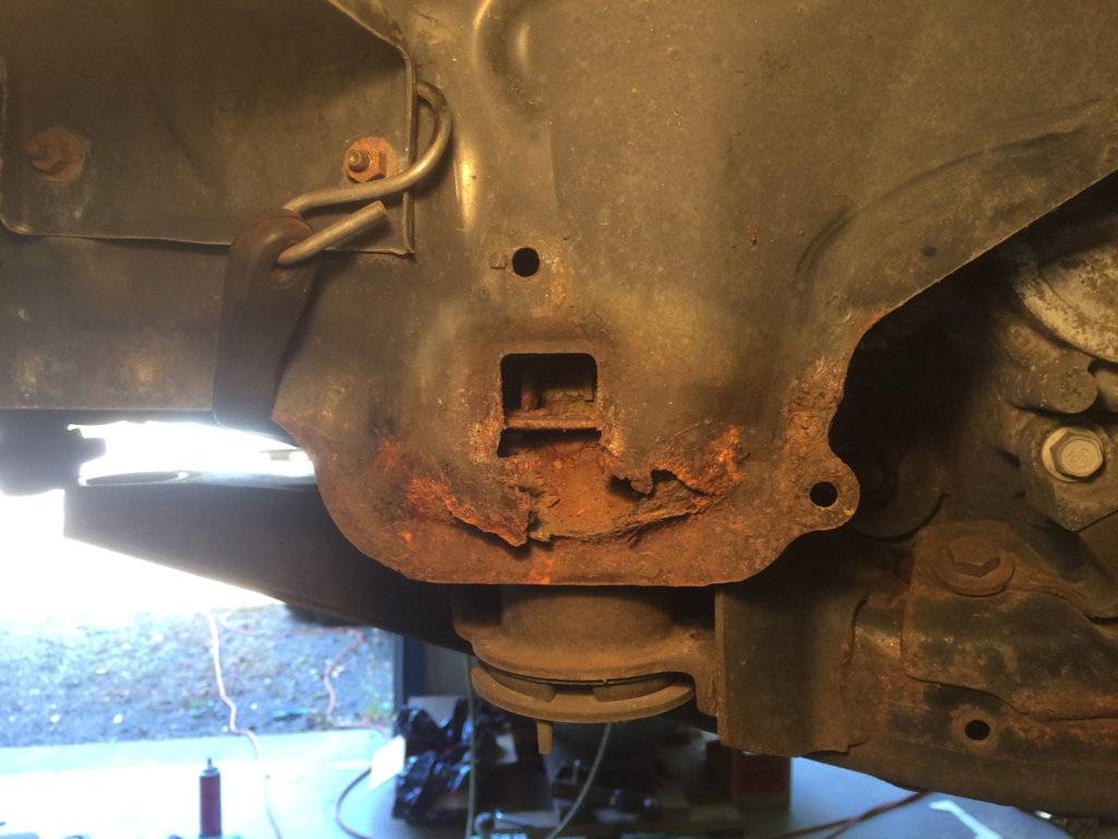

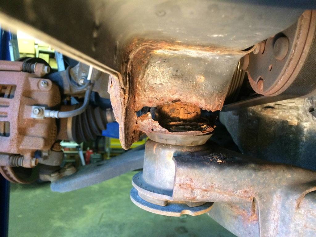

Here's a fairly serious problem that's developing on 2002 to 2007 Saturn Vues driven in areas that use road salt. The body structure where the subframe mounts to the front of the vehicle is rotting away. If you own one, or maybe one of your children is driving one, you definitely want to have it looked at, especially if you live in a state that doesn't require safety inspections. I looked at four of them last week, and they all had the same issue.
This week's other project in the shop was to repair the rust on this '06 model, with less than 85K miles.
The right side mount was no longer attached at all.
Poor design: Low area fills up with dirt and stays damp all the time.

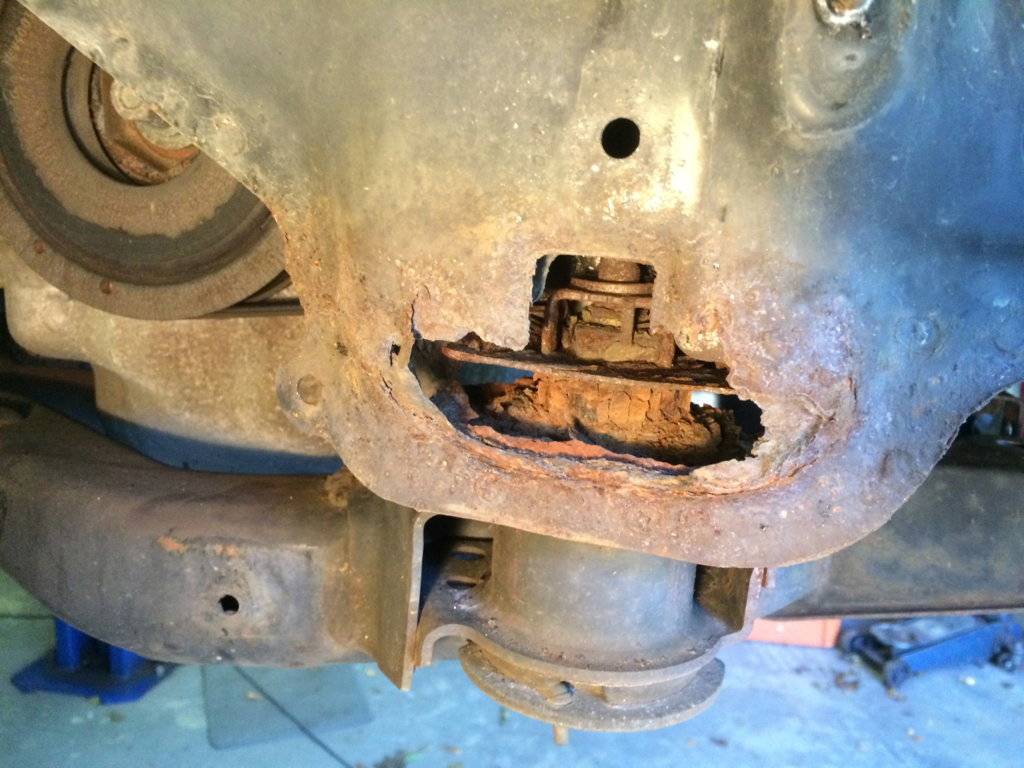

After bolt was removed

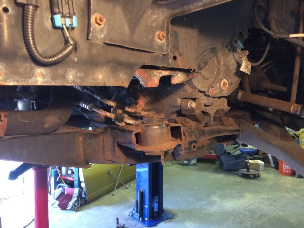

Left side looks better, but it is still in bad shape.

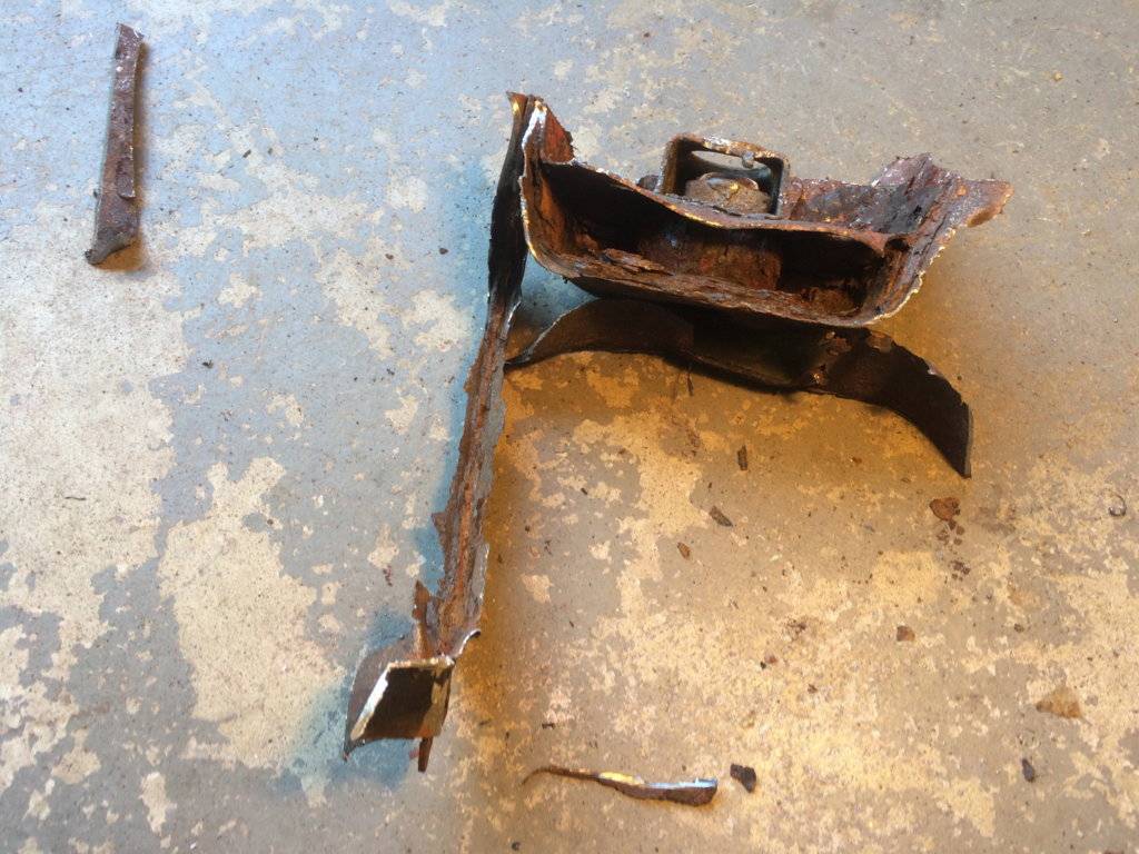

Rusty metal cut away
Although still in tact, it's paper thin

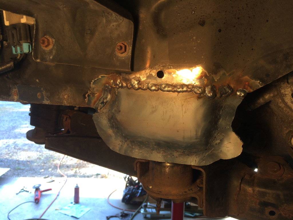

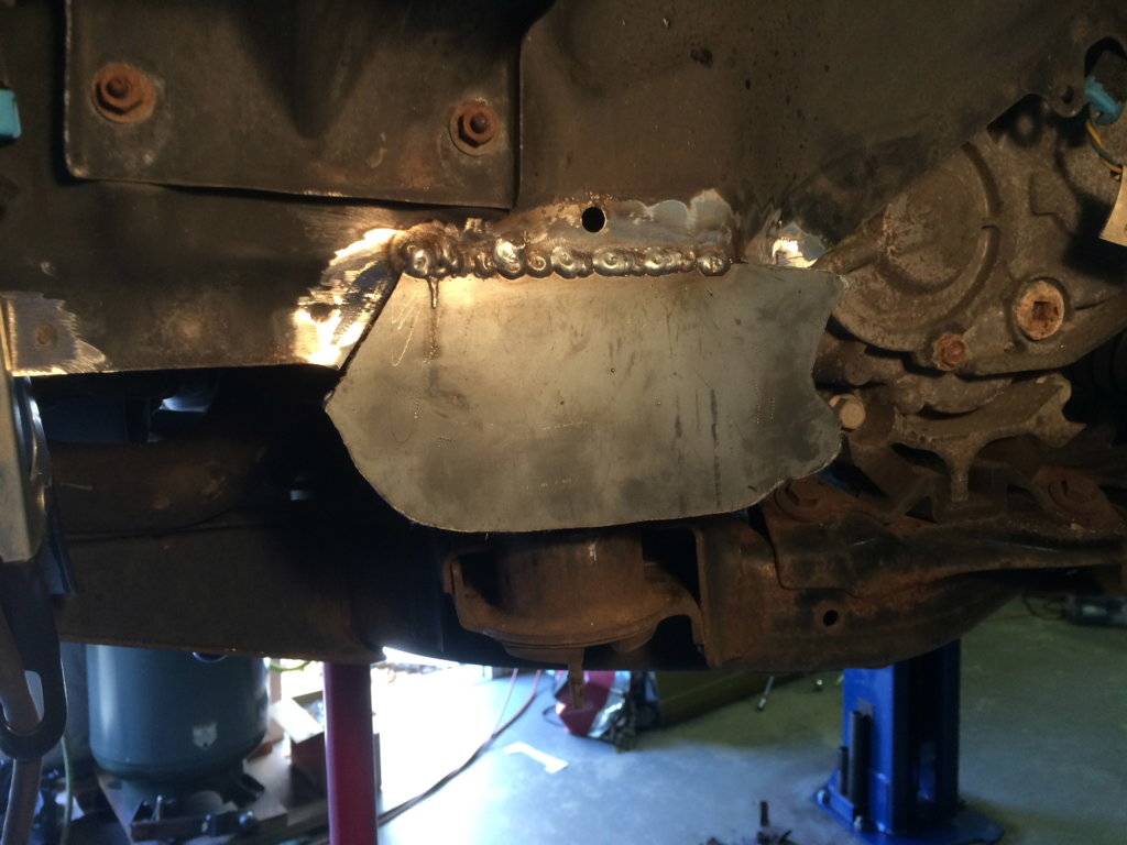

The sheet steel I had in stock was a little thicker than the original, hence the ugly-looking weld

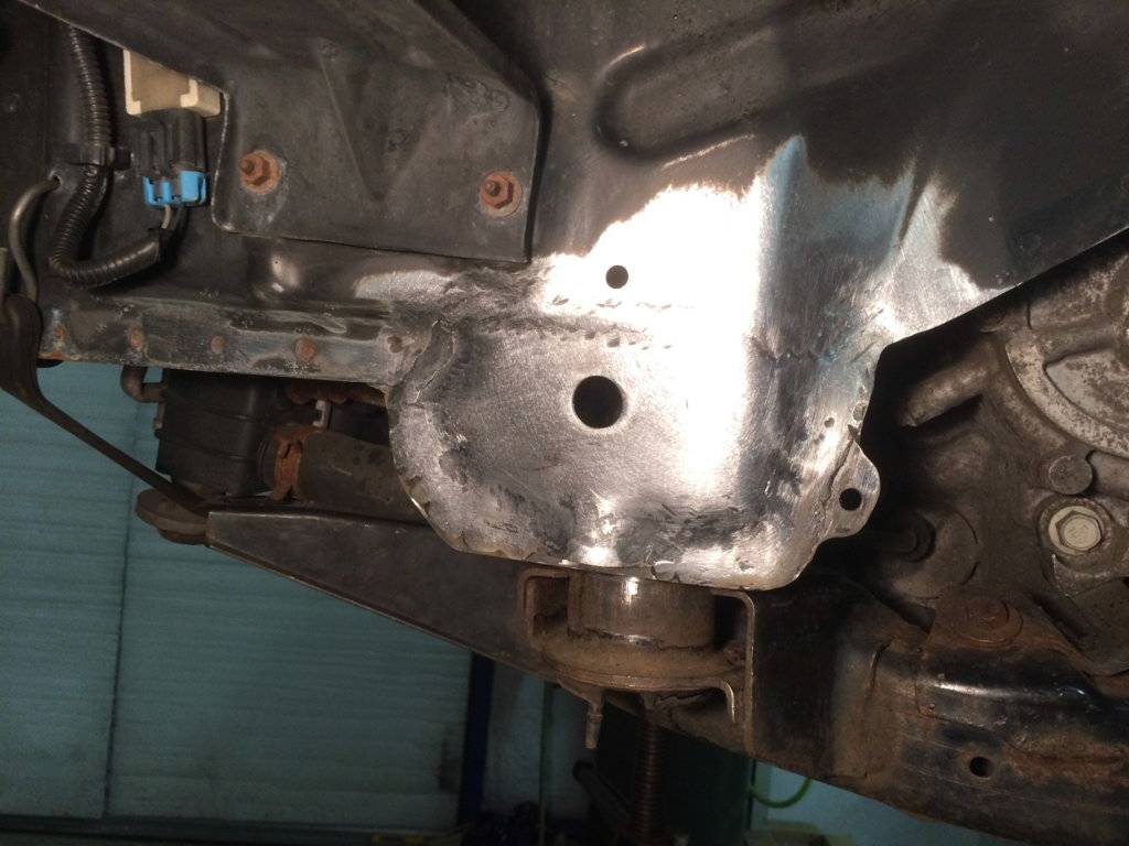

Heated it up to form it into shape
Added a drain "bump" at the bottom to help prevent it from rusting again

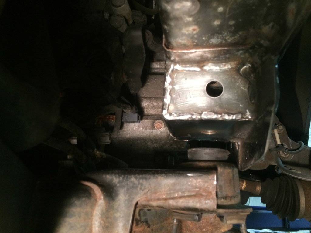

New box for the mount to bolt to
Terrific job on the repair!!
