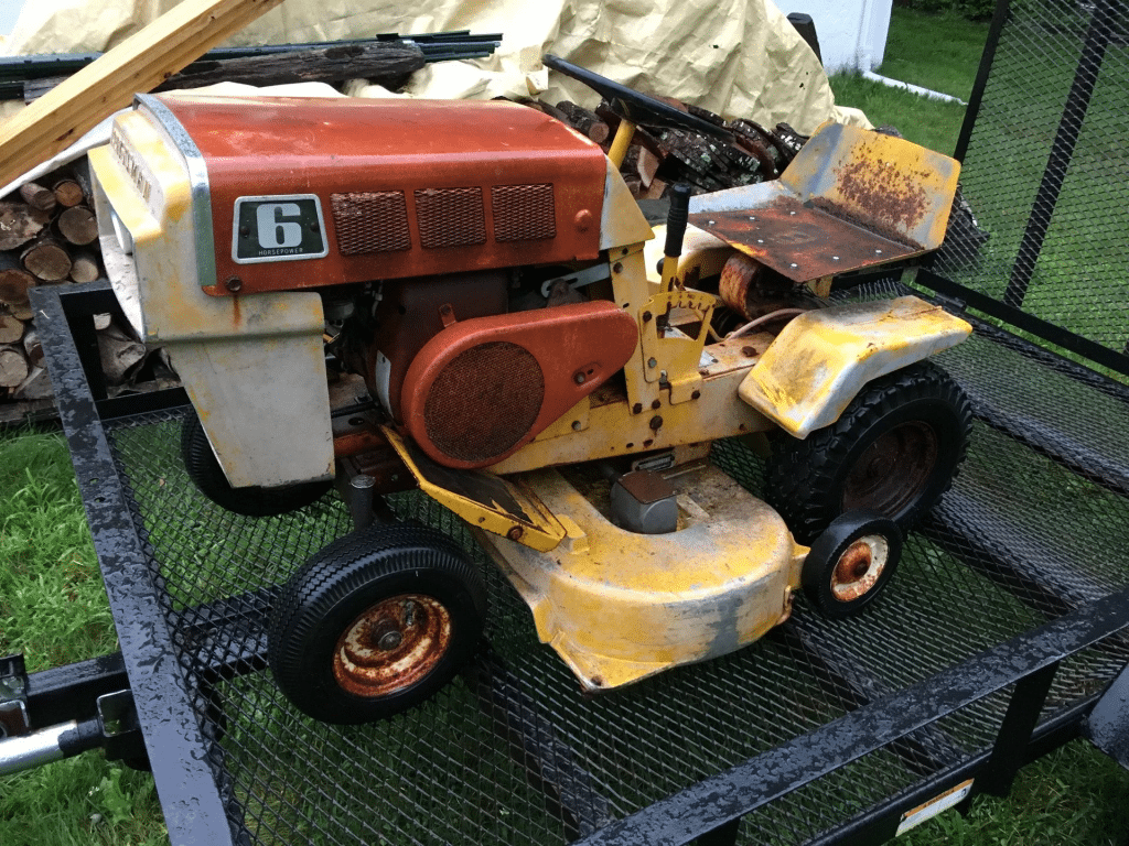

As some of you may know my other interest besides Mopars is tractors and I am currently restoring one. The engine on the tractor has not run in 15 years or more and is going to need to get rebuilt; which I will attempt to do myself with my stepdads help as I never rebuilt a small engine and he has.

ok thats a .010 oversize ring set...which would require you to bore the cylinder .010 oversize and install a .010 oversize piston...when you're talking one cylinder Tecumseh i assume this is a lawn mower you're restoring, not a farm tractor ?....no you dont want old rubber parts...metal stuff, if its not rusted or corroded is fine...i put army surplus 1945 bearings in a hercules engine a couple years ago...they were wrapped in so much wax, cloth and cosmoline it took over 20 minutes just to get them out of the packaging and they probably could have been stored underwater...needless to say they were fine...but a cardboard box in a damp shop or left out in the rain at a swap meet a couple seasons is another story so just cause its nos doesnt mean its good
It is a lawn tractor unfortunately not a farm tractor no, this exact one here is the one I'm restoring.....
