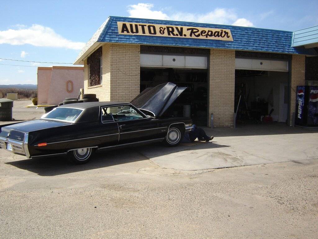

I have driven many Mopar from California, Washington and southern states to Toronto Canada with an overall good check of the components and a feel of the car. If what I went for was too far from safe, it did not go for the road trip. Most all the ones that I did drive were currently plated so I could go for good test before taking.
The one big fail I had was in a Caddy, the AC compressor seized and cooked the belts, oh and a water pump in a van, but I knew it was iffy and got stupid thinking it would go the distance. Both fail cars were AC cars, The dozen others regular none AC cars with less stress on the belts and engine. Engine timing made a big difference on California cars, they were all retarded and drove like slugs till I would set the timing for the engine.

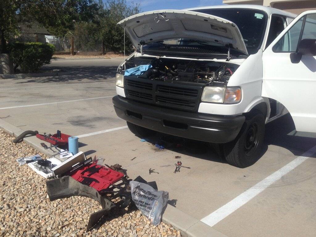

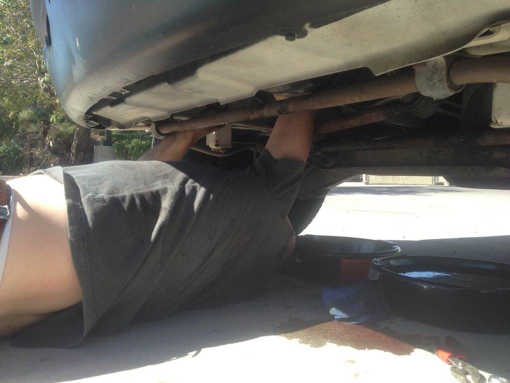

Me wrenching the road trip machines.
The AutoZone counter guy was very helpful with letting me wrench in his yard and lending me the pulley wrench for water pump change. Funny thing tho, the new pump didn't last a year, install a dealer part on the next swap.

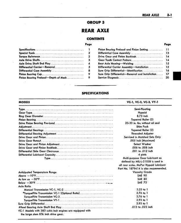

Imperials came standard with 2.94 gears yes? Unless that’s maybe the later Fueselage years
