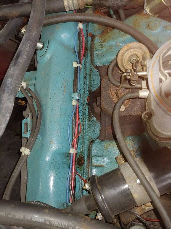

26 inch radiator, and it is noticably louder like an exhaust leak sound but it's not an exhaust issue and there is splatters of oily soot on the valve cover
If it is a big leak at the heat riser passage, exhaust is flowing thru the head to the point of least resistance, ie the leak. This brings a bunch of heat with it. you should change the gasket for the intake. Be sure to clean up the area around the heat riser ports well as they are probably carboned up where the leak is. Might also want to check the heat riser to be sure it is not stuck shut as that might have overheated the heat riser passage under the carb and toasted the gasket at the ports.

Don't mind my wiring mess and zip ties, here is the sooty mess of something going wrong
