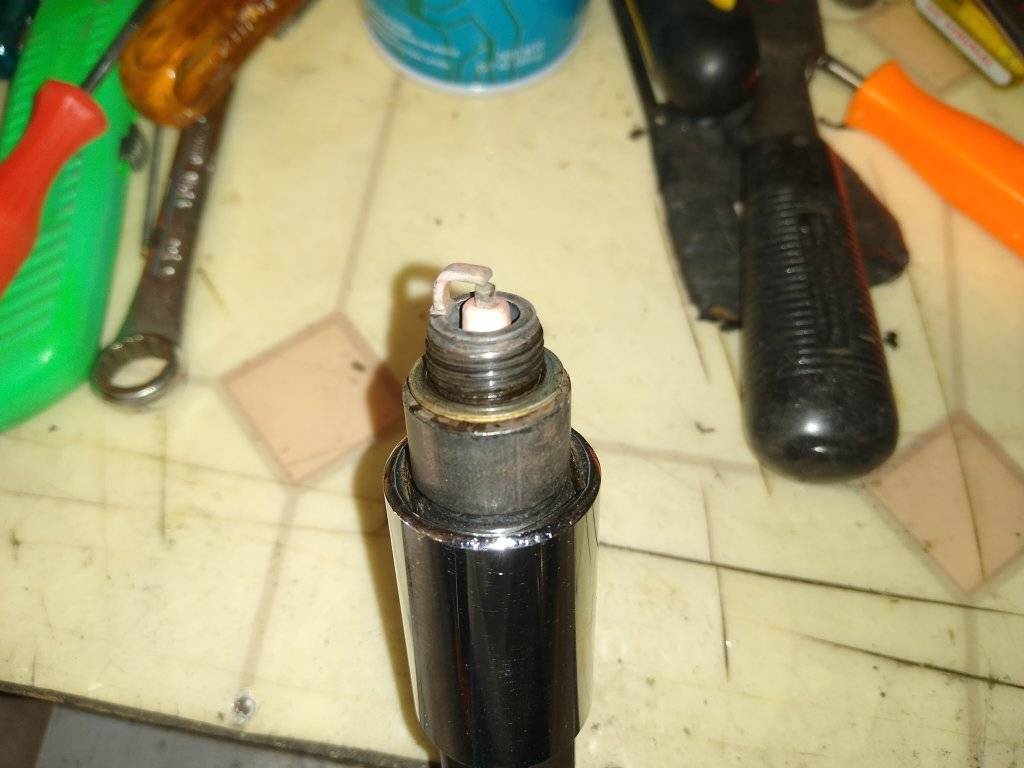

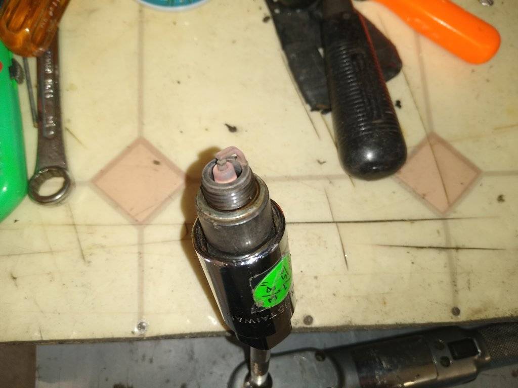

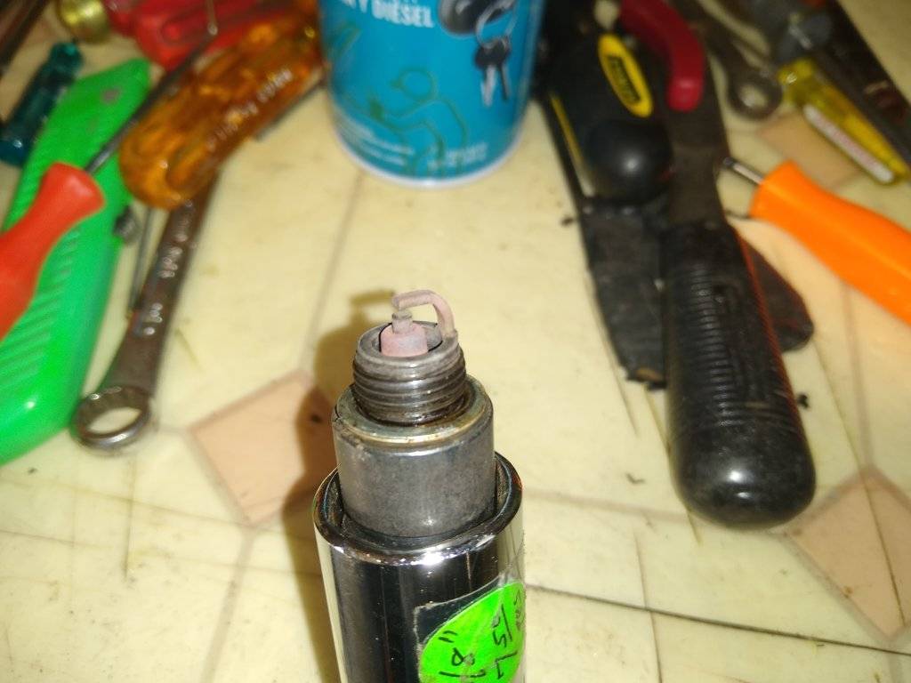

At this point only the high tension wire is showing an unsteady light. All spark plugs are uniform light in color.
