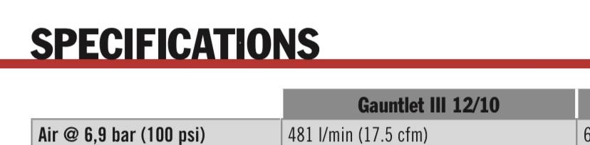

This is the air specs they give.
I’ll have to talk with somebody at the company that knows more than the sales guys.
Thanks for all the help. I knew I didn’t know what I needed.
What ever the press does, it requires 17.5 cfm at 100 psi steady flow. The psi is the carrier, the cfm is the working volume. That's a LOT of working volume! Does it show any other specs?
