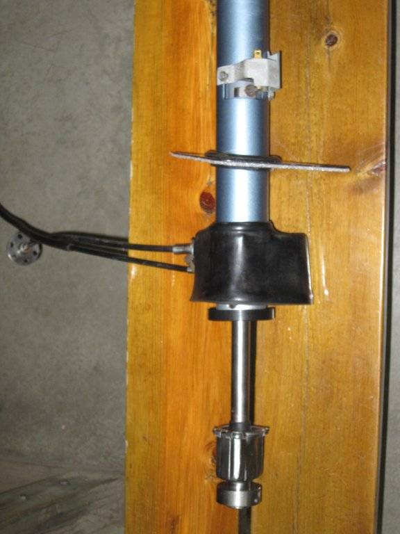

I do not know if the Fury column is similar but, attached is a photo of my 65 Coronet column for reference.
Mike

That’s some great information on the subject, thank you all for your input this will be a great guide when I dive into this!
Steve weim55 Colorado
