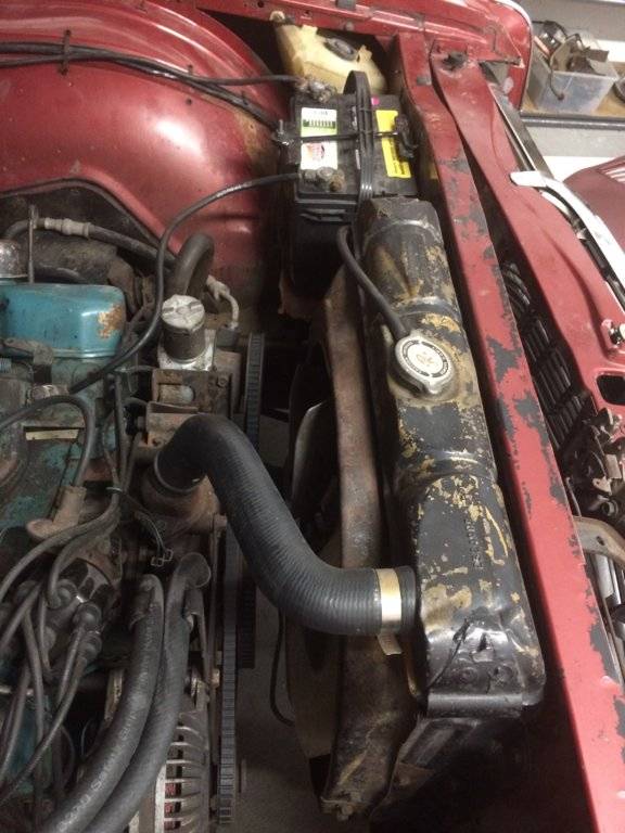

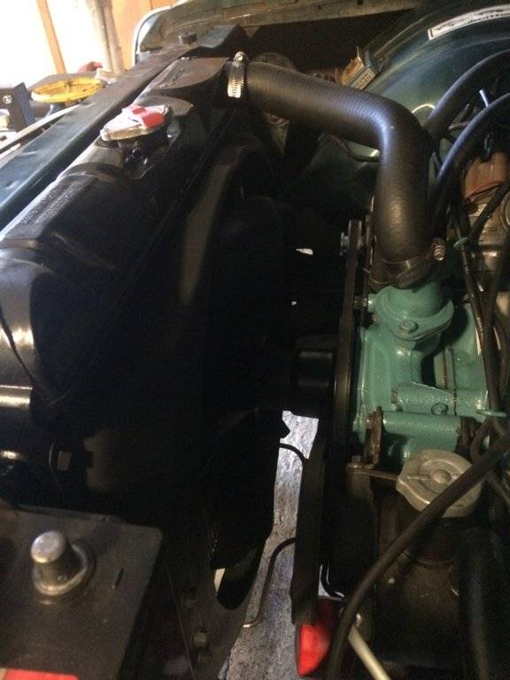

Here are two non A/C cars, non max cooling cars, both 413 300 L’s.

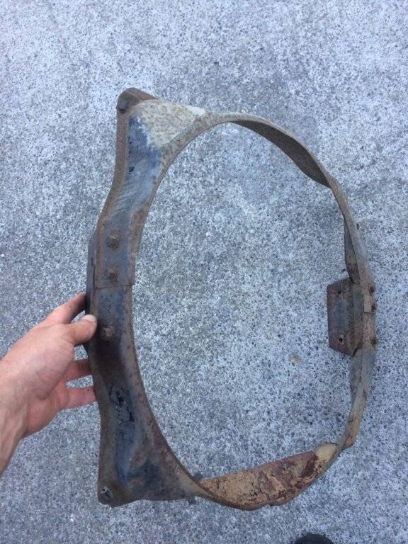

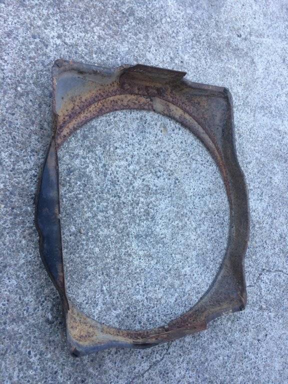

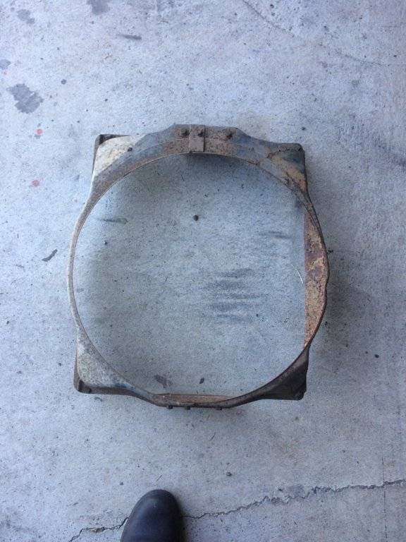

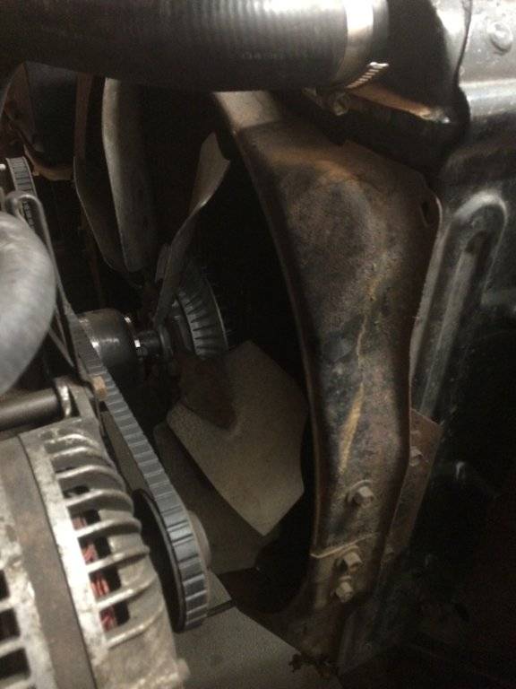

This is from a 65 300 383 2bbl.
It’s for sale if you need one...it’s actually from a friends parts car. I’ll ask him if you are interested.
It’s a two part unit which will break down for shipping.
