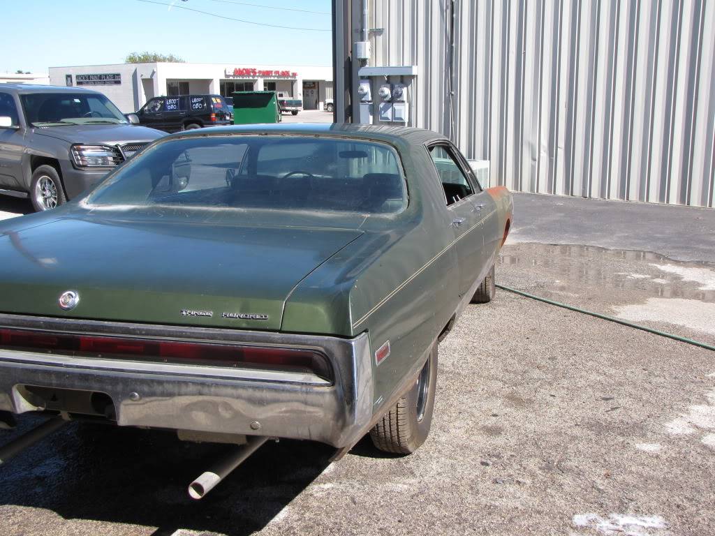

Here's a recent pic of my 300, took it outside, washed it off of dust, blew out the dust from the inside, took stock of where I am; still looks kind of clean after all these years off the road; last time I had it registered was 1984!

the wiring is getting sorted out, should be firing this baby up for the first time on a new motor this coming or next week.
It's the same engine; just .30 overbore, .10 down on the crank journals, re-done heads, and 10.1 pistons (think they may be too much). New cam and lifters and all...check the Donny's 300 thread over at forbbodiesonly.com for more of this thread, actually before this site was made the b body site was all that was there.
Look forward to your updates. The car looks to be very worthy of rescue. Also being electrically challenged I'm always looking to learn. What is your friend doing with the wiring? Hope you leave the colour as is since nothing says late 60's and early 70's like that shade of green. If it was mine the tail pipes would get tucked up under the rear bumper. My .02
there's a tail panel valence the covers down on those pipes, and if they are too long, I'll trim 'em back.
Yeah, Wayne (wiring guy) knows what he's doing, he's super MOPAR smart, which is good!
If I was not up to my eyeballs in this Camaro, I'd be all over the 300, should be hitting it tomorrow for a bit more...
Ignition Control Module; fried it up on an earlier hair-brained scheme; gotta get a new one! But, it's been a LONG time since I heard that distinctive whine of a MOPAR starting...spinning the 10.1 440 HP motor; that alone was worth it!
