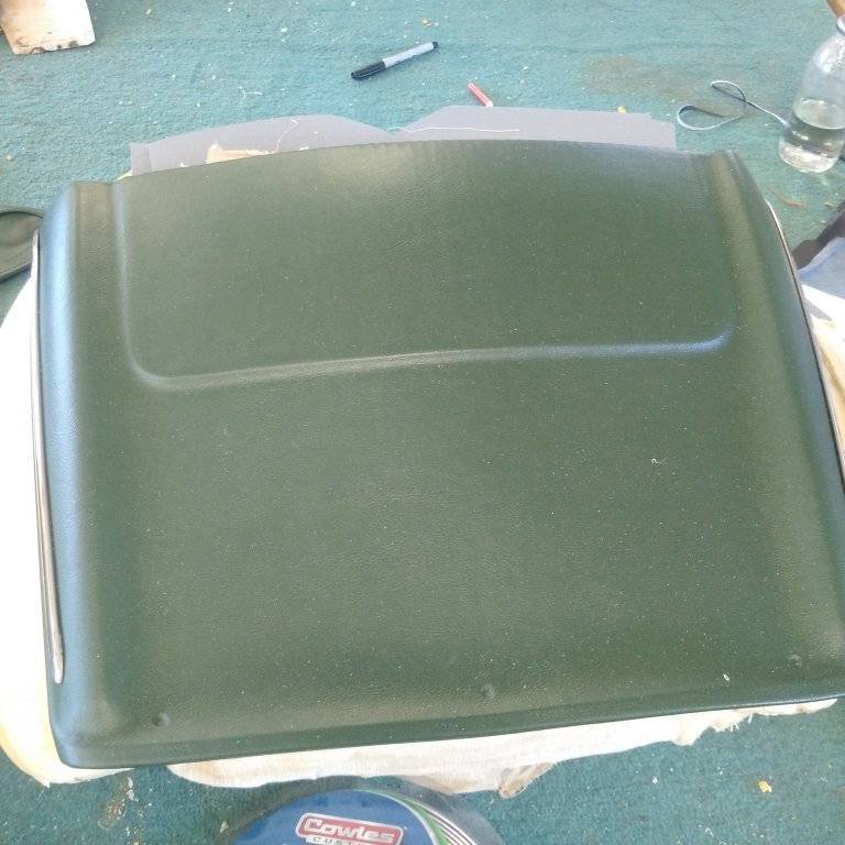

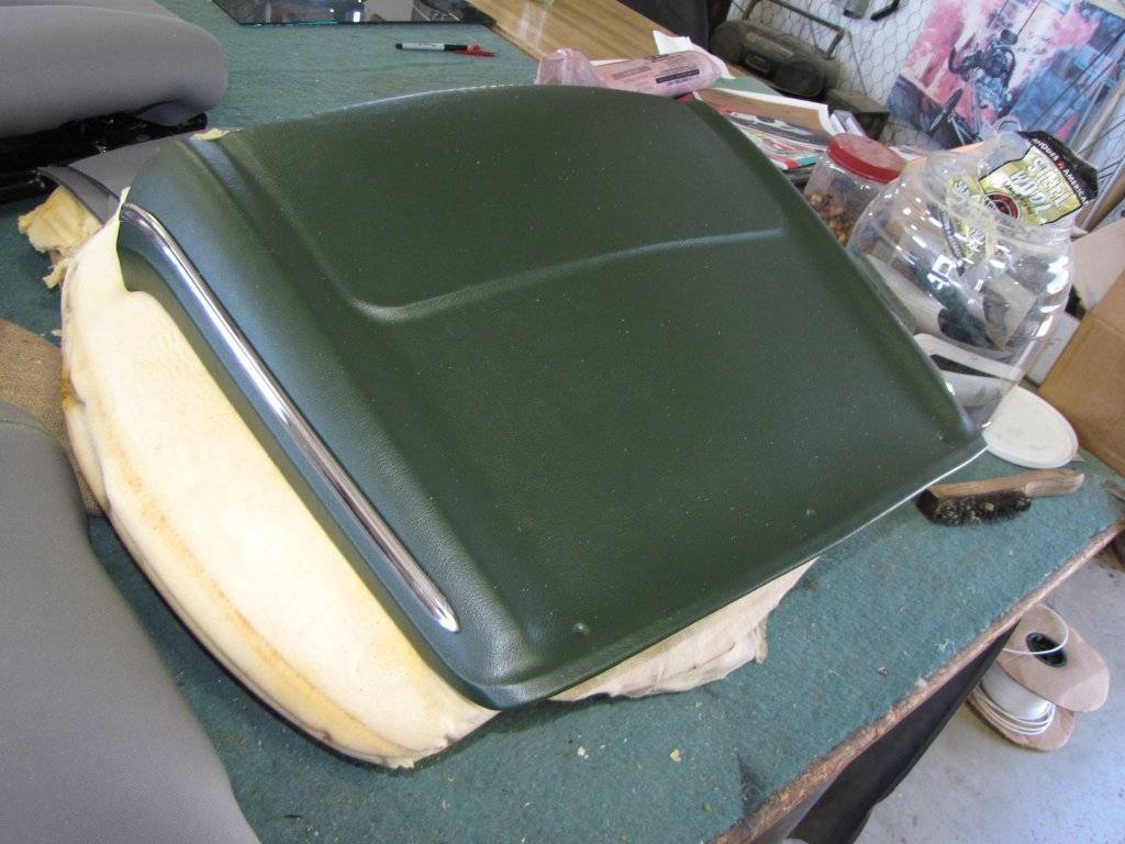

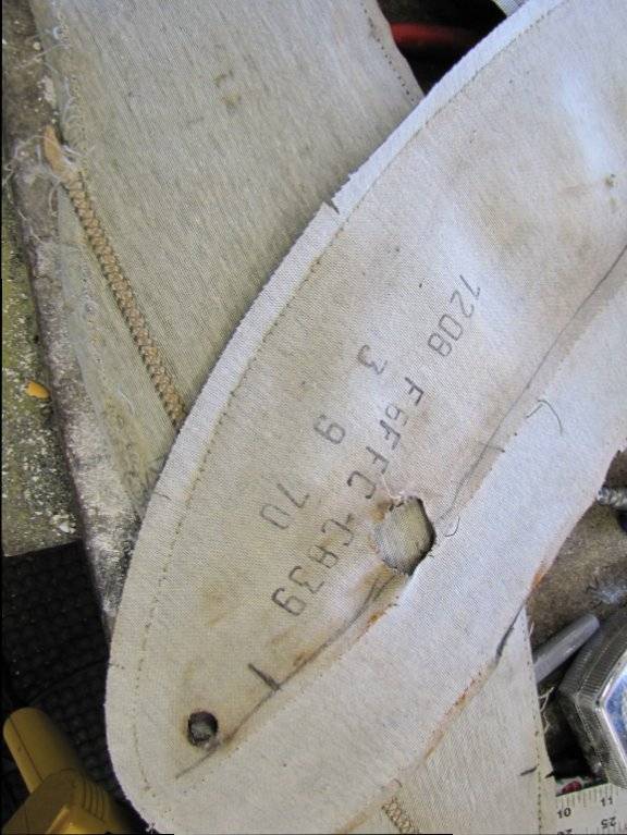

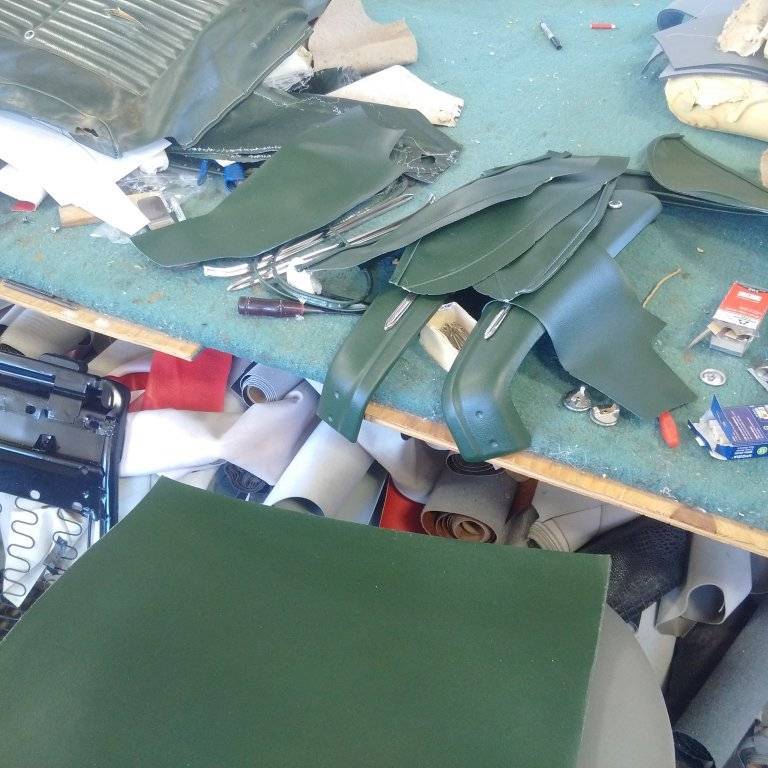

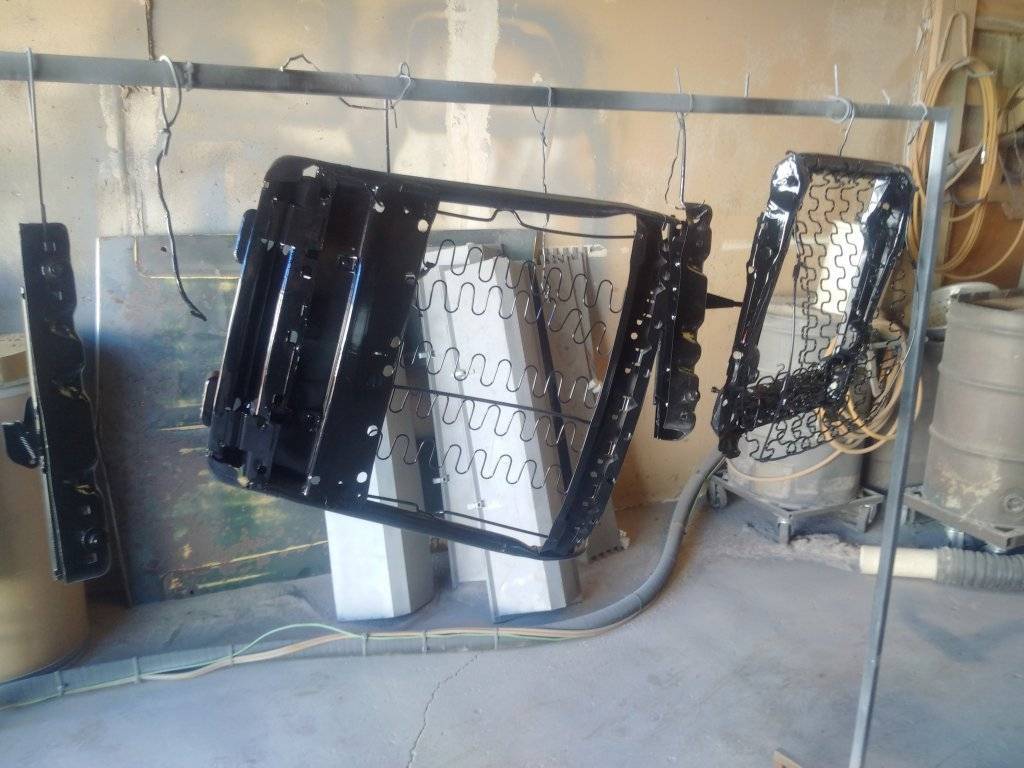

Getting the Seats re-done, all custom made new covers, old ones removed and new material ordered and the shop is making my seats new again! I blasted the seat frames, epoxied 'em and got the build sheet recovered safely too!
