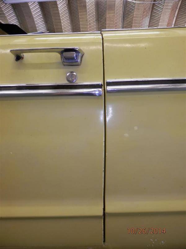

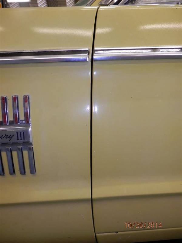

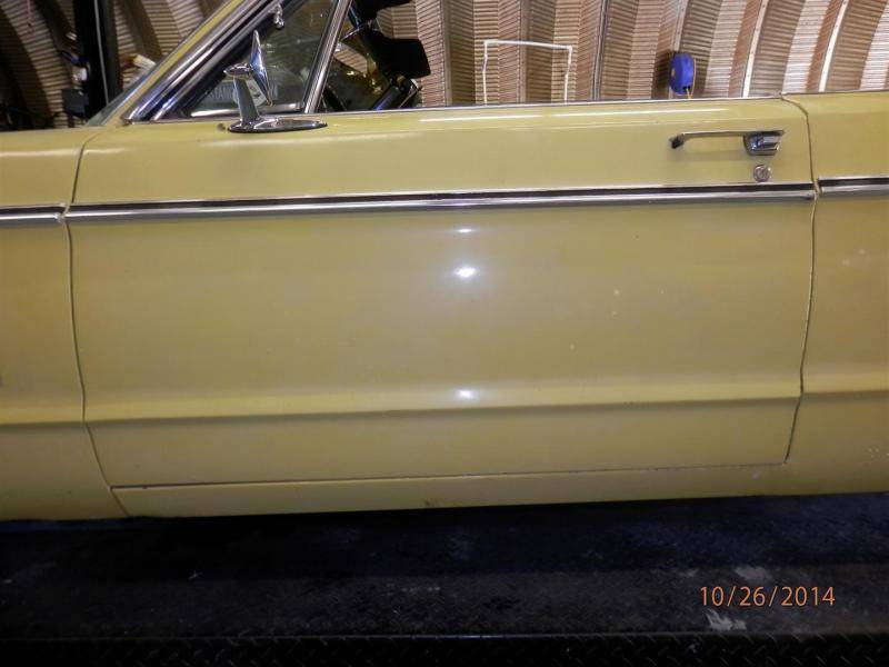

Driver side door - door opens/close with ease. As you can see, the rearward lines do not line up, not sure where to adjust from, the forward lines all look good, wouldn't any adjustments change this? Kel

Looks like it could be sagging from worn hinge. Open door about half way and pull up on the rear end of the door. Check if the hinge pins and bushings are worn. A good hinge will rock the entire car without any play.
Definitely some up/down play, will add hinge bushings/pins to list, thanks! Kel
