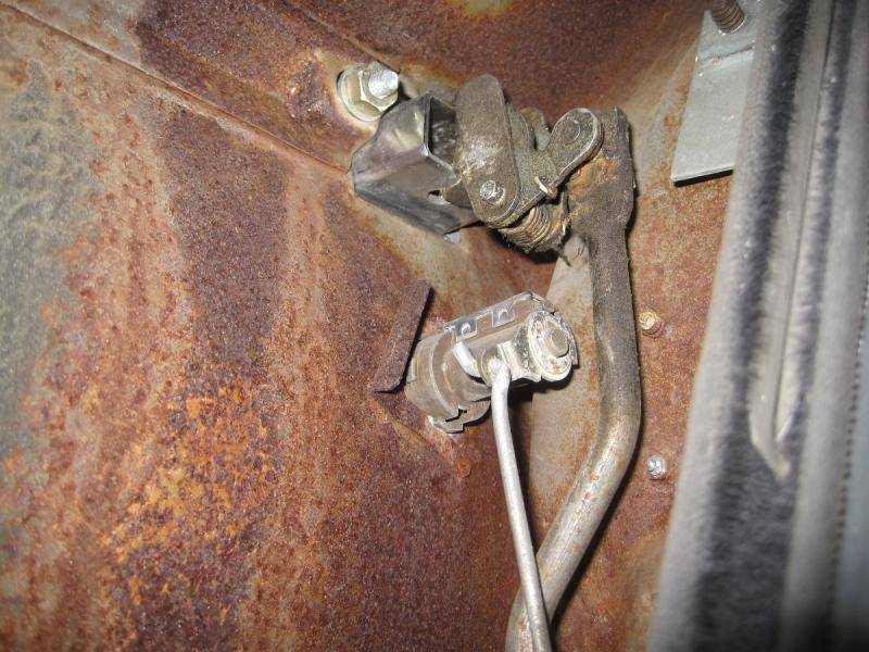

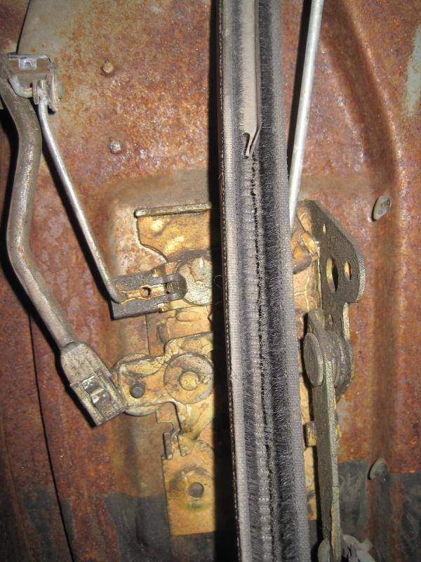

I really can't help you but I took some pictures of the lock mechanism and can see if at some point someone didn’t re-install them correctly or as you can see from the photo that the lock linkage can not be switched but maybe it is some how twisted around the door button linkage.
Thanks for the pictures, Z.

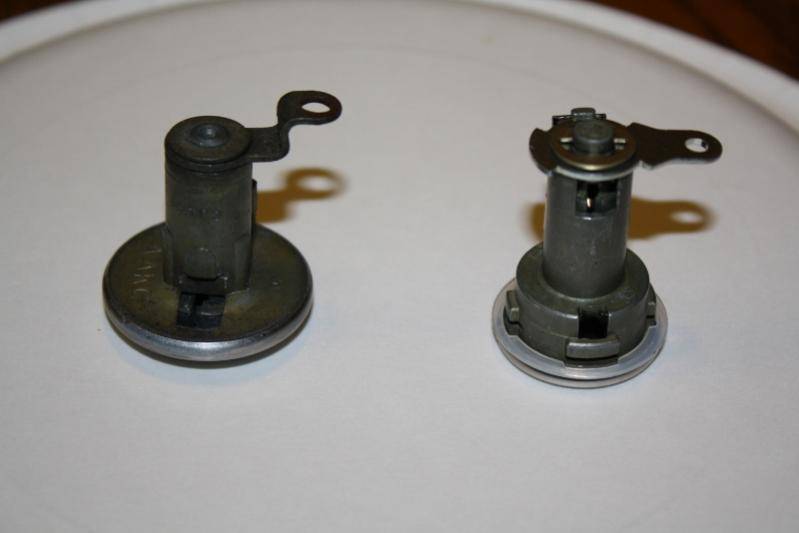

The new locks DO NOT fit my door.
The lock on the left is the original lock. The one on the right is the new one from Rock Auto.
Notice the huge difference in the diameter of the bezel and the diameter of the lock body. The hole in the door will not accomodate the new lock.
I have already sent a message to RockAuto to tell them of the issue.
The worst part is that I have spent another $40 to have the new locks re-keyed to use my existing key so I have about $55 tied up in a set of locks I can't use unless I start modifying my door lock opening.
I have done some preliminary searches for OE locks without much luck so far.
What would you guys do?

Do you have part numbers and where did you search for door locks?
It may not be as simple as enlarging the hole.
There are 4 lugs on the replacement lock that look like they may need to lock into something.
If the hole is bored out large enough to accomodate those lugs, there isn't anything to hold the lock in position to keep it from rotating when you turn the key.
The old lock has some markings "AAKC" and "CJ144" that don't bring up anything usable in a Google search.
I may just take the old lock to a locksmith and see if it can be made functional.

Or bore the hole to the right size and use a file to file the notches....easy.
What's wrong with your original locks? I don't think your issue was with the locks themselves. Maybe you can take them to your locksmith so he can have a look at them. I wouldn't be boring out holes in my door. Worse case scenario is you get a set of good originals from Murray Park or National Moparts and have them keyed to match your ignition key. I know you are already into these replacements for some $$$ but in my book, there is only one way to do things: the right way. I'd be willing to bet your originals are in good working order or your locksmith can fix them is they aren't.

I used the pictures that Zymurgy had posted. Mine looks exactly like the pictures. I tried manually locking the latch with the rod disconnected. Same result. I did verify that the lock goes all the way into lock mode with the rod attached or disconnected. The pictures don't show it, but there is a small tab that seems to be somewhat rounded off that is the part of the lock system that holds the latch in place when the lock is activated. I know that isn't a very good description but it's the best I can come up with.
