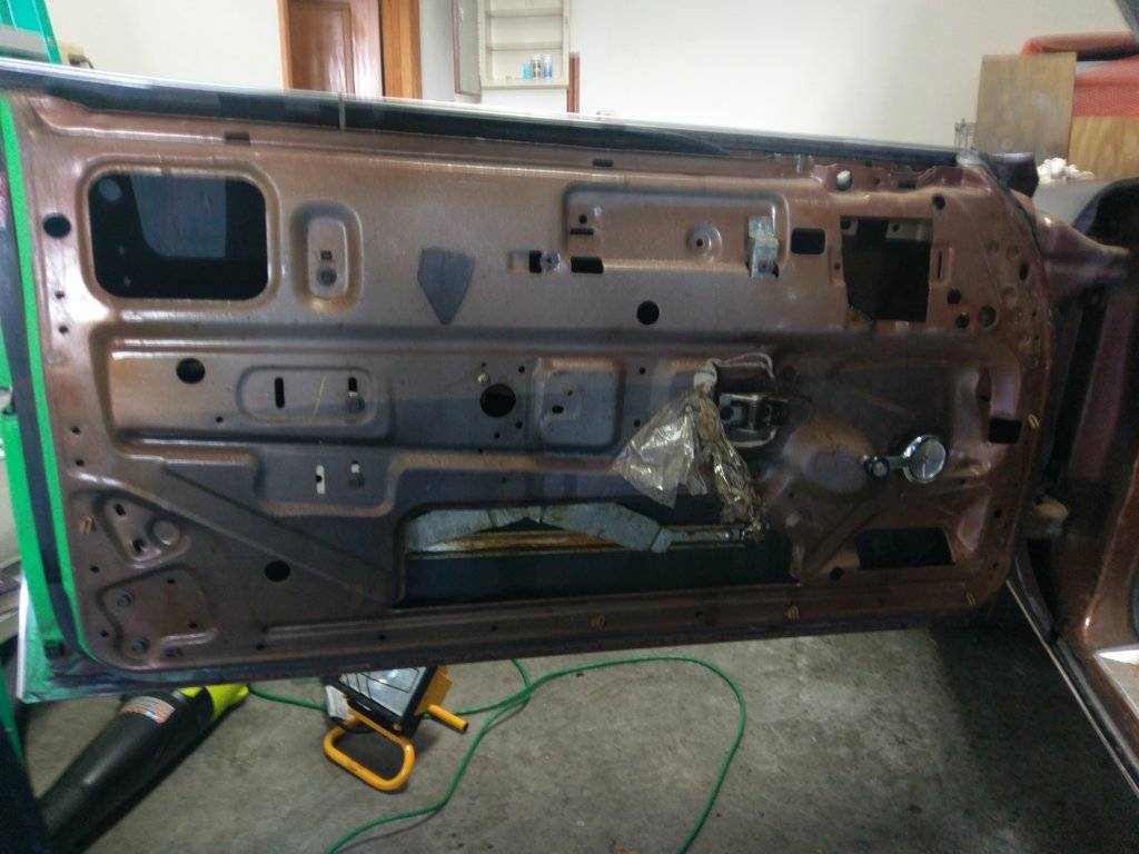

    Panel off, thanks

    Excellent! And thank YOU for actually following up and showing that the advice given here was actually put to use! :thumbsup:

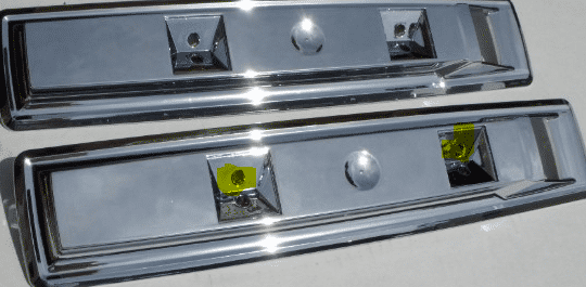

    I noticed that the trim plates for the door handle are chrome painted plastic. Some of the paint has worn off. Is it just a case of rubbing down and painting with chrome paint? Anyone refurbished these?

    Seat Backs Hinge Covers | ABC Moparts also is reproducing these and many other interior parts that are top quality but they may be pricey for a driver but that's subjective. Comparatively his prices are pretty good and he's a good guy to deal with.

    Sometimes you can just flip them from one side of the car to the other. That flips them and exposes better surface.
    You can also buy new ones from Vans or someplace like that.
    Chrome paint isn't.

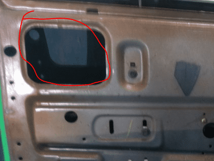

    Is it possible to remove exterior door handles without removing the glass?
    If i hav to remove glass, is it just the two screws holding it to the mechanism?

    Yes. It just takes a little patience.
    Don't take out the glass. You will regret it when you start putting it back together and getting the adjustment right.

    If you roll the window up with the door panel off, you should have enough access through this large hole to access the nuts connectors for the door handle.
