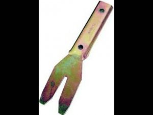

Apr 30, 2013 #1 1 1969 300 New Member Joined Apr 30, 2013 Messages 40 Reaction score 2 Hi, I was wondering how to remove the interior door panel on my 1969 300. It looks like it is held in w/ clips, but they wont budge. :sSig_noob: Thanks
Apr 30, 2013 #2 commando1 Old Man with a Hat Joined Mar 10, 2011 Messages 37,380 Reaction score 38,543 Location Sebring, Florida There is a trim removal tool you can buy at any auto parts store. It slips under the clip so you can pop it out. < Sent from my tablet >
Apr 30, 2013 #3 1 1969 300 New Member Joined Apr 30, 2013 Messages 40 Reaction score 2 Perfect! Thanks
