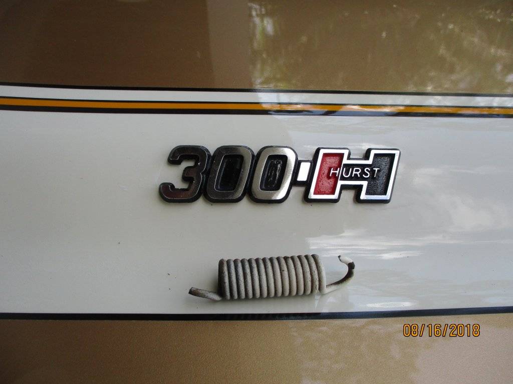

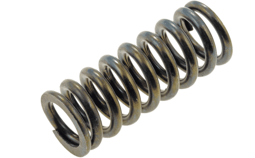

First, a spring is a spring, unless it's a specific torsion spring like those used in the EBod doors. So, if your door uses either a compression or a tension spring, you can find a match at Depot or the McMaster catalogue, etc, etc. You'll need to measure and match the length and diameter of course, but the diameter of the actual wire is equally important so measure that very accurately. If you don't have a dial caliper your local hardware store will have a cheap plastic version vs. a $$$ stainless steel instrument.
As you can see, I came very close with a visit to Depot, but with exact dimensions the Internet can find it for your instantly.

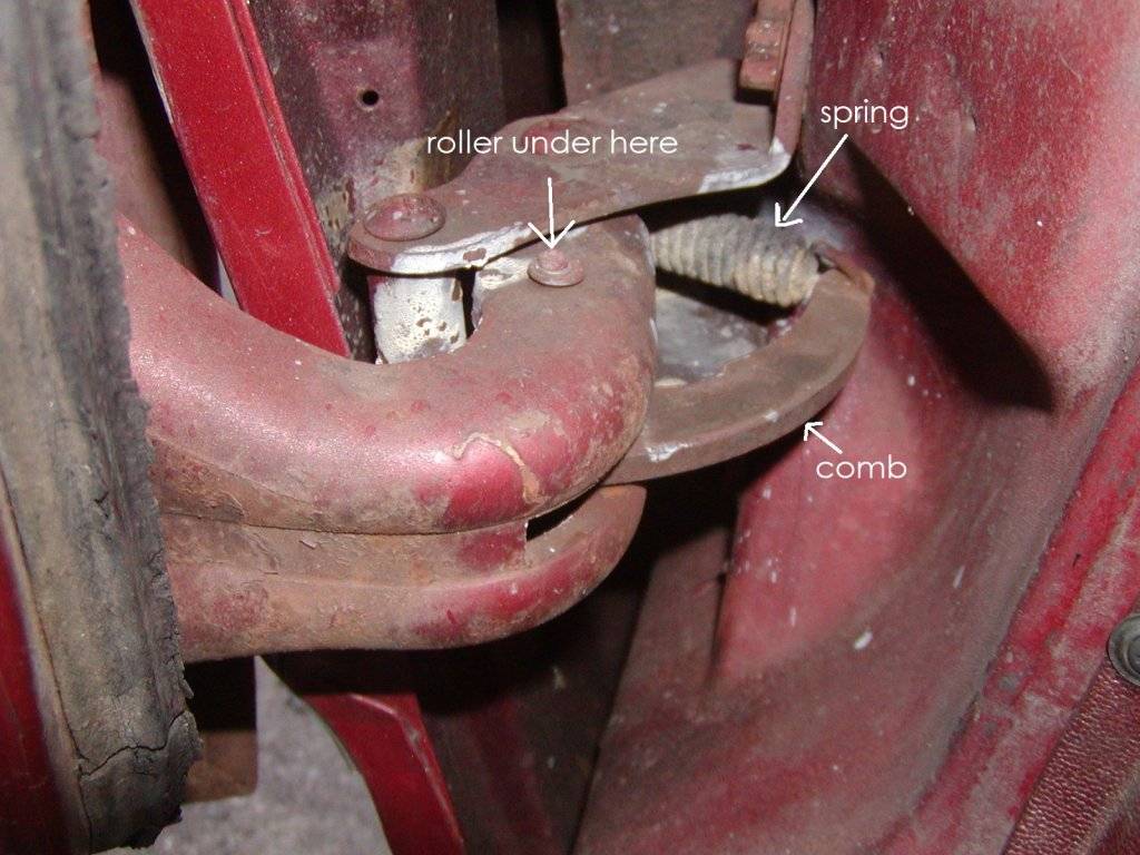

This is a hinge on my '65. There are 3 parts that hold the door open (4 if you count the pin that holds the roller) I don't suspect you will find the comb or the roller separate from a replacement hinge.
This looks the same as my 66 Imperial. Here is where I bought the repair kits
