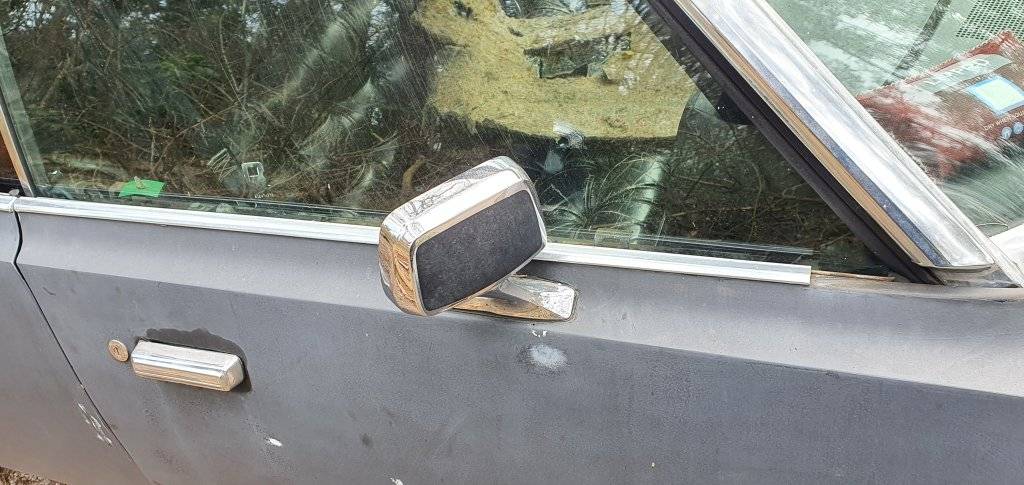

So here's the thing, I've never removed trim before but from what I can tell it's pretty delicate and easy to mess up. I'm looking to remove the trim on the top of the door, pictured below, and can't really tell how it's attached to the door.
Also, the door mirror is being a real pain, can that be removed without taking out the glass? Access seems real tight so if anyone has done this before I'd like to hear some pointers
Car is a 1975 Imperial by the way.
Any and all help will be appreciated
Door glass will not need to be removed, but you will need to remove the armrest and door panel, and raise the glass all the way up. Having thin arms and such to get into the door to get a socket on the one or two nuts that hold the mirror onto the door will help.
Thanks Ross, that is good to hear since the FSM doesn't mention the mirrors whatsoever. Would you by any chance happen to know what size socket fits those nuts?
Nope, but I would assume you need deep sockets to fit over the studs and nuts, likely 1/4" drive because they're small, and a long extension to get you down where you can move things around and have room to twist the tool.
Good luck!
I'll figure it out, the hardest part will be reaching them and if that works out I should be able to reach them again with a different socket if I have to
That just leaves the trim which I'm hoping someone can point me in the right direction. Will be attempting a home paint job and these will be the last hurdle :)
Sorry - forgot to answer that - the trim is likely held on by spring clips that snap into pre-drilled holes in the door body. The clips can usually be squeezed and pushed back up through the holes. If they are plastic clips, they may have a central plastic bit that pokes through and spreads the clip out. Pull that bit out, but don't lose it. The clip then should be free to collapse and you can push the clip up through the hole.
You may find that it's a combination of those type of clips, and that once you've got the one off near the rear edge of the door, that the molding will slide along the remaining clips, and that the molding will have one or two reliefs in it that are not visible when it's installed, but allow the molding to come free of the clip.
You'll need the plastic piece to spread the clip out again when reinstalling.

Great succes, the trim and mirrors are removed!
It was indeed very very fiddly as access was terrible but the mirror nuts were 3/8 as expected. Socket didn't fit but was able to get a box wrench in there.
For future reference, the trim on top of the door has the same style clips as the door cards so no real trouble there.
