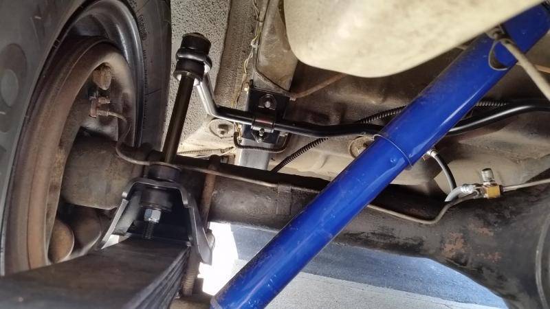

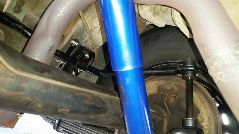

Go with Firm Feels rear sway bar. It's pricey @ $399, but IMO totally worth it! Like the saying goes.... "you get what you pay for"
I was going to go with the Addco from Summit... then thought about PST's (but looked just like the Addco).... but settled for Firm Feels and glad I did. I contacted PST to inquire about their bar and asked if I could see the installation instructions as I wanted to see how it was mounted. I was told no instructions were available for me to see and "we've sold many with no complaints".
I did not get the warm fuzzies with that answer and didn't want to spend $$ only to have to return it on my dime. I contacted Firm Feel, got my questions answered, purchased and have no regrets.
http://www.firmfeel.com/c_body_mopar_rear_sway_bar.html
