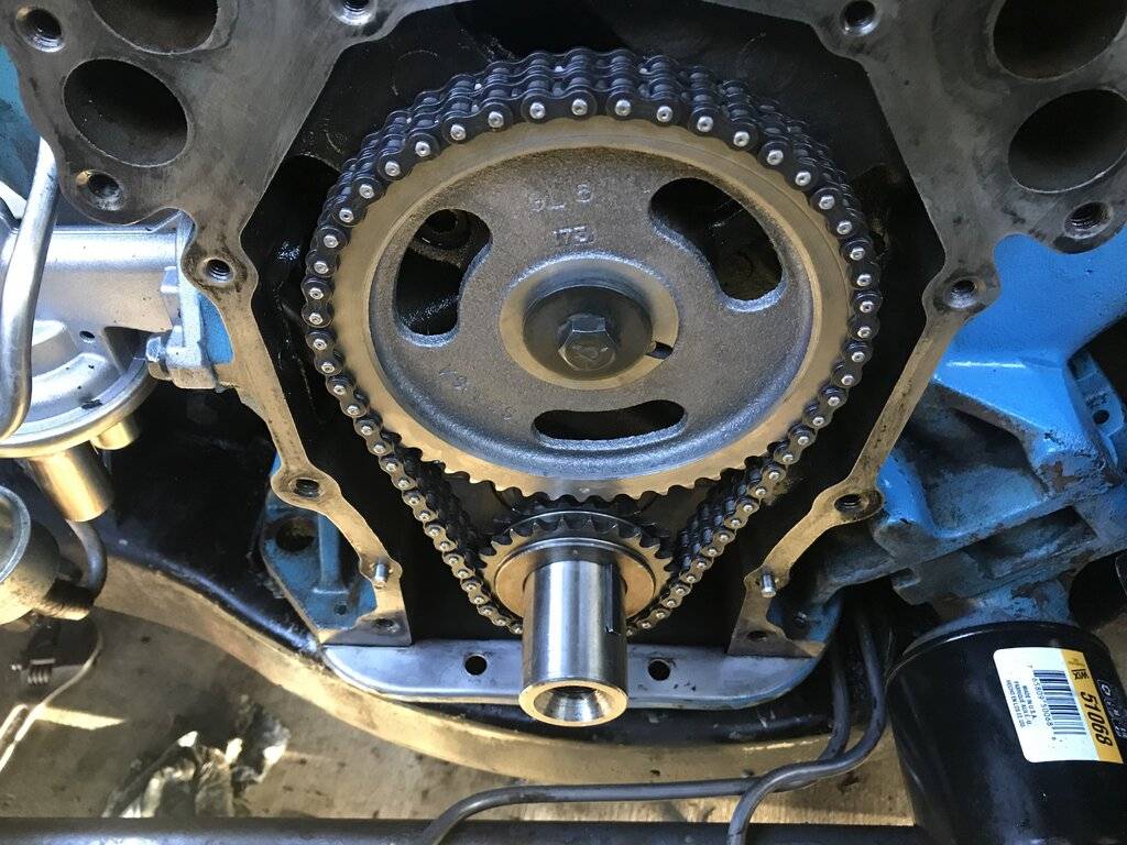

  20. Gerald Morris
    Gerald Morris Senior Member
    Messages:
    1,147
    Likes Received:
    254
    Joined:
    Mar 9, 2016
    Location:
    Tucson
    I copped a double roller last Christmas for Mathilda, removing an old OLD Cloyes-looking single, which may well have come with that engine off the line. That tightened up my timing AND runs quieter than the single, though not by much. VERY happy. I thought about gears, but liked what I got from those guys in Carrolton, Tx very much.
