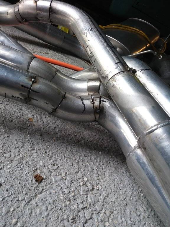

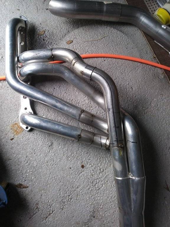

Just some pics to document what it takes to make these work.
The driver's side fit great OOTB, the passenger not so much.
It took moving 3 out of 4 pipes.
The first effort to install was to make some dents. While they would fit, it looked like crap.
Anyone wanting to go to a 2" header may want to look at different offering to start with.
The torsion bar has plenty of room on either side for the tubes, but they go down right on top of the bar..
A few J pipes later, they are fixed. There is absolutely no joy in chopping up a brand new ceramic coated header. Now to take them to a buddy to tig weld them up, then find a ceramic coater to redo them. Here's what I ended up with.
The last pic shows kinda sorta where the pipes contact the T bar. The front tube was originally inside the T bar, now it it outside.
