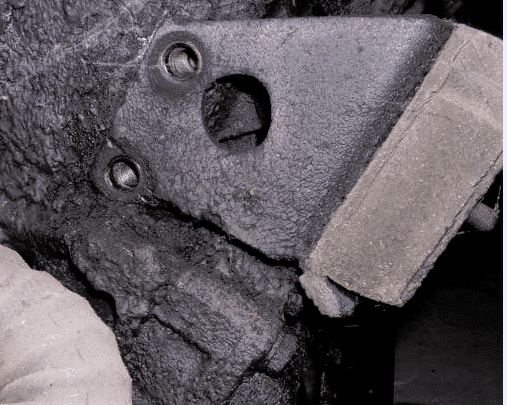

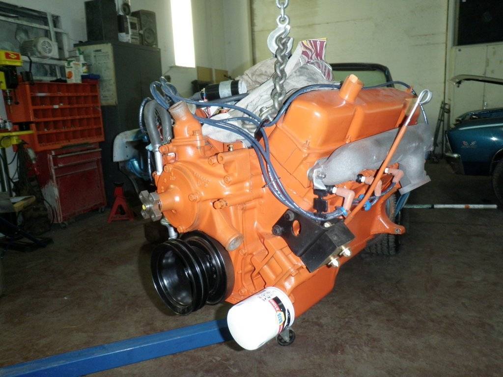

Can't help you with the poly setup, but the big block looks about like this:
And with the mount out of there:

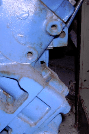

A cleaner shot of the special tapped bosses:

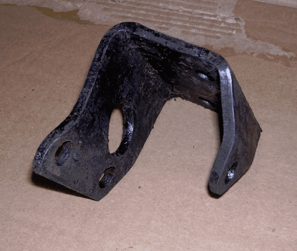

This is what the bare bracket looks like, but again, this is big block specific.

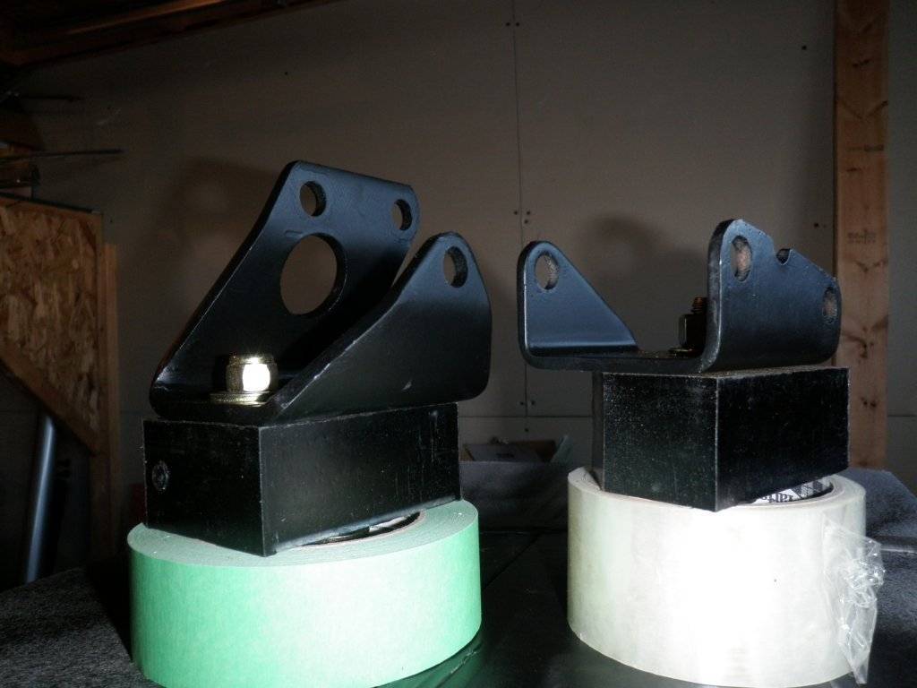

Although their site refers only to B and RB motors, I believe the 65 mounts are all the same except slant 6. I could be wrong.
Call them and check...
