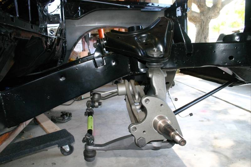

I don't follow you. If these are new parts where they're relocating the axle shaft up on the spindle relative to the attachment points, i.e. keeping the top where the upper balljoint attaches and the lower holes where the lower balljoint/arm attaches in the same locations, then the balljoints aren't any closer together than stock.
There was someone that was selling a C-body disc conversion kit using B-body spindles, which would have had alignment problems such as you're describing.
Funny thing is, these look like drum spindles, not disc spindles. My guess is they expect you to use these in conjunction with someone's drum-to-disc conversion kit.
In looking for pictures of spindles I came across a helpful forum post where someone measured the dimensions of several Mopar spindles.
Using C-Body spindles on an E-Body ( and A-Body LCA's & Viper calipers) in Wheels, Tires, Brakes, Suspension & Steering
The dropped spindle moves the hub center 2" closer to the upper ball joint. The lower ball joint still attaches to the spindle in the same orientation to the hub center. The net difference between the ball joints is 2" less with the dropped spindles. I'm no chassis engineer but just lowering the car with the torsion bars can introduce problems with bump steer.
Now most of us will probably never notice it as we are not pushing the cars to their limits but the variance is still there and because of that I do not like it.

If you chop the spindle above the brake mounting, that will move the ball joints closer as the lower ball joint still mounts in the same location.
Alan
Does it say that these were made by shortening the top part of the spindle? To my thinking, all you want to do is move the wheel and brake caliper attachment points up relative to where the balljoints attach. That would retain the same overall height of the spindle, so no change to the suspension geometry. If these are brand new parts, as opposed to reworked old parts, then they should be able to do that.
Just eyeballing it from the pictures, it appears to me that the stub axle is further up from the mounting holes for the LBJ than it is on the stock spindle, the top arm looks shorter because they've made the main body taller to have somewhere to mount the brake hardware, and the overall height is the same as stock. Of course you'd have to call and ask FF to confirm that. :)

I've been talking to a guy at Firm Feel, and the ones they're showing now aren't going to work for me.
He said there were other people interested in a spindle that would accept Chrysler rotors.
The current ones don't. They use drum brake bearing specs and are made to use aftermarket rotors like the drum to disc kits use.
They are looking into getting a different spindle made to use Chrysler rotors. Keep your fingers crossed!
