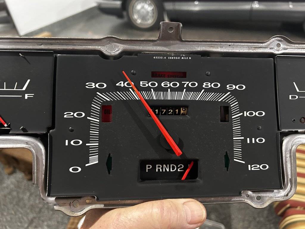

In cleaning up the plastic face of Elwood’s instrument cluster, I dropped it. Now the speedometer is reading oddly.
Can I fix this or is there a source that can fix?
The needle moves freely but seems to have a mind of its own as to where it stops.

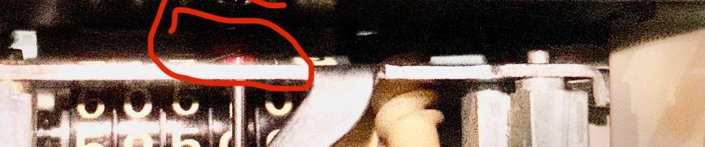

it appears that the metal bracket that the end of the clock spring is attached to has become detached from the back of the speedometer.

It’s hard to see in the picture, but the copper colored clock spring should be attached via a small L shaped metal bracket to the back of the speedometer.
