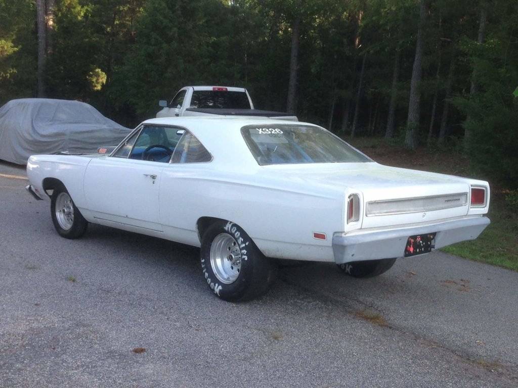

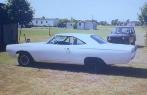

In 1999 I painted my old drag car in Centari white. No clear coat. Only two coats of base. It was so brite that for years when in direct sun light you couldn’t look directly at it without wearing sun glasses.

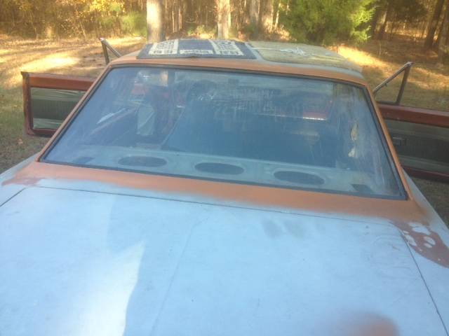

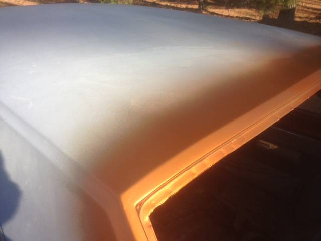

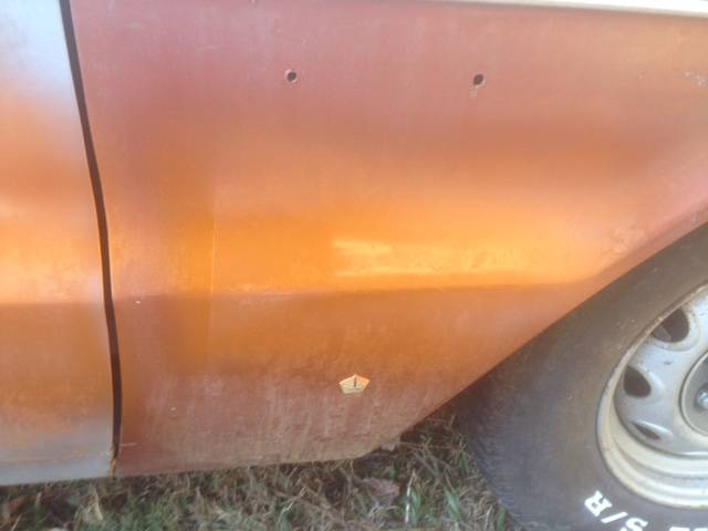

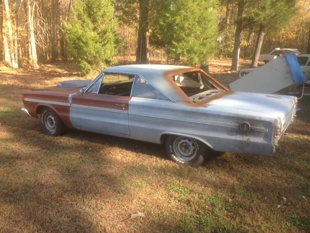

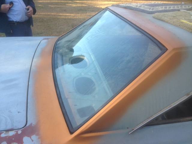

Just for kicks I thought I’d try that Dupli-Color pre mix stuff they sell at the parts stores since I do a lot of race cars. I tried it on this Belvedere. It needs to be wet sanded & cleared. I also shot a spot right over the old paint on the fender. Shines pretty good. This is likely what I will paint FURYIOUS with. $300 for everything
