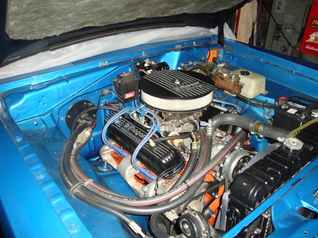

i've used it , and so has my buds . it works great . about half the head pressures and it don't leak down like the others do . works with any oem or aftermarket a/c systems as well . this duster puts out @ 56 deg temps from the outlets . and its been done for years .
